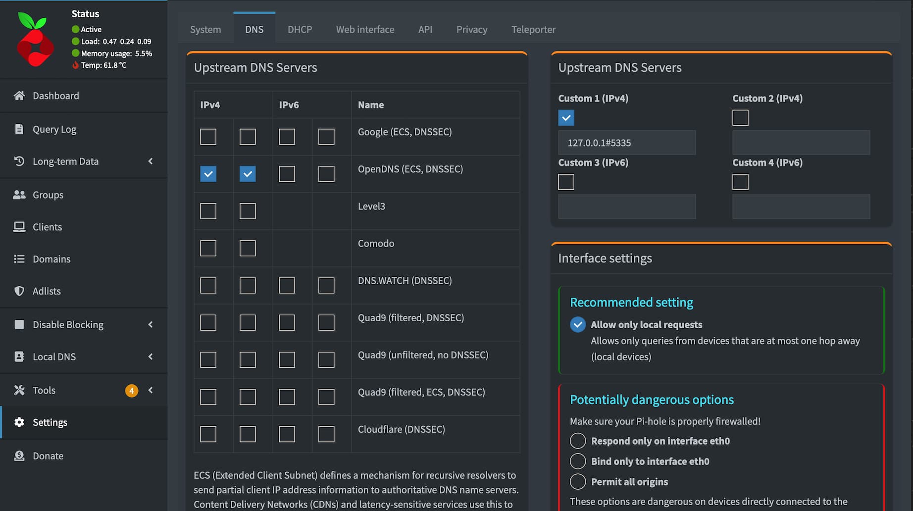

Hi i have reconfigured the pihole, but it doesnt look like there is much difference. I still get errors for
[✗] No IPv4 address(es) found on the eth0 interface.
[✗] No IPv6 address(es) found on the eth0 interface.
The main difference between now and before is that while reconfiguring i have used opendns servers rather than using unboud and wireshark. (not clue how to get back to using these two)
I have changed from eth0 to wlan while reconfiguring, both were available in settings to be picked from.

Your debug log indeed shows that your Pi-hole is still using eth0.
If you successfully ran Pi-hole's Reconfigure, this may possibly hint at file permission issues. Perhaps you run your Pi with a read-only file system?
You just put them back in as Pi-hole's Upstream DNS Servers via Settings | DNS.
