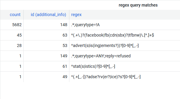

  • the additional_info field is only used for regex blacklist entries (and cname data), all other (white and black) list entries never get additional info.
  • although I have several blacklist regexes, from lists such as mmotti, adguardteam, nextdns, ... ,very few entries appear in the additional_field (thus never triggered by a query).
Looking at the results (grafana):
same can be achieved with this query (It may not be wise to run this if you don't have a MAXDBDAYS setting, limiting the number of entries in the database, I use MAXDBDAYS=8):
pihole-FTL sqlite3 ".timeout = 5000" ".headers on" ".mode column" \
"ATTACH '/etc/pihole/pihole-FTL.db' AS pihole_FTL" \
"ATTACH '/etc/pihole/gravity.db' AS gravity" \
"SELECT count(pihole_FTL.queries.additional_info), gravity.domainlist.id, gravity.domainlist.domain FROM pihole_FTL.queries \
INNER JOIN gravity.domainlist \
ON pihole_FTL.queries.additional_info = gravity.domainlist.id \
WHERE typeof(additional_info) = 'integer' \
GROUP BY additional_info ORDER BY count(additional_info) DESC;"

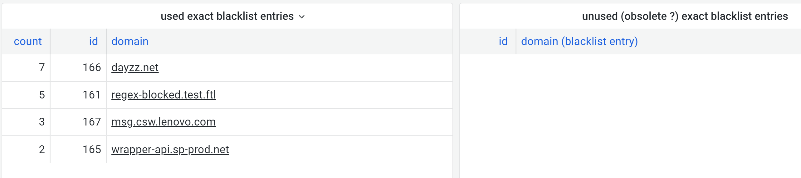

query used to list exact blacklist entries, with id:
"SELECT count( pihole_FTL.queries.domain), gravity.domainlist.id, gravity.domainlist.domain FROM pihole_FTL.queries \
ON pihole_FTL.queries.domain = gravity.domainlist.domain \
WHERE gravity.domainlist.type = 1 \
AND pihole_FTL.queries.timestamp > strftime('%s','now','-10 days') \
AND pihole_FTL.queries.status IN (1, 4, 5, 6, 7, 8, 9, 10, 11, 15, 16) \
GROUP BY pihole_FTL.queries.domain ORDER BY count( pihole_FTL.queries.domain) DESC;"
grafana result (with id), there are no unused blacklist entries, thus no data:

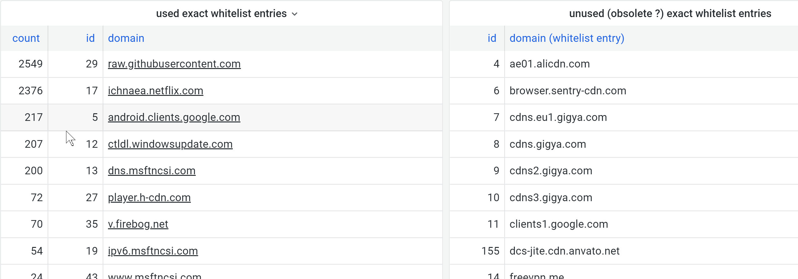

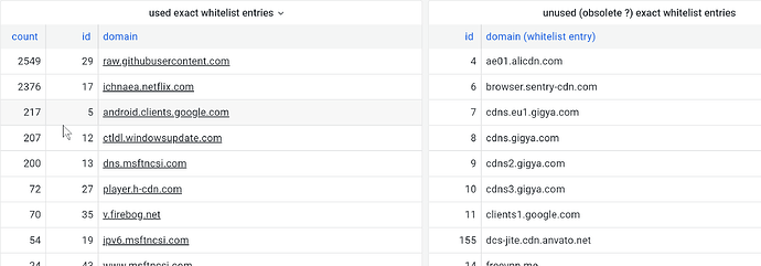

query used to list exact whitelist entries, with id:
WHERE gravity.domainlist.type = 0 \
AND pihole_FTL.queries.status IN (0, 2, 3, 12, 13, 14) \
grafana result, partial:
thus already possible, except for regex whitelist entries. Wouldn't mind at all if this was added (additional_data).
