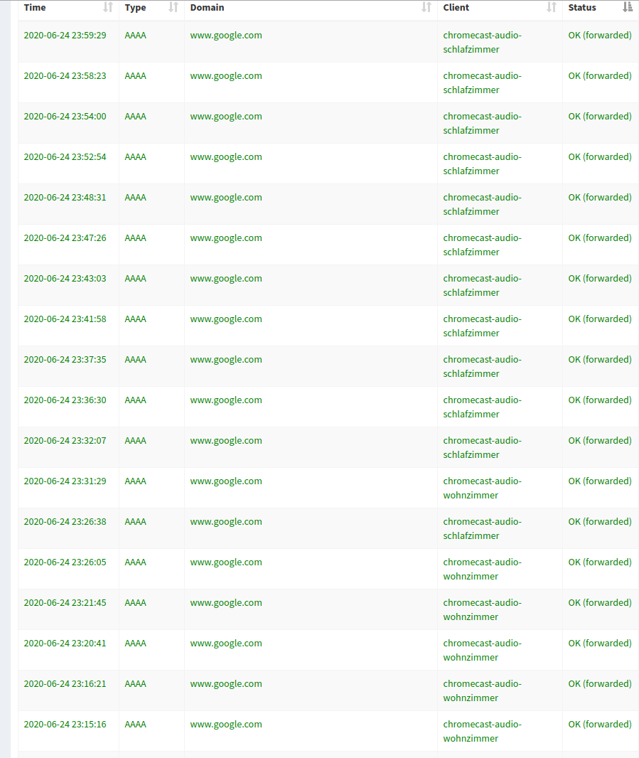

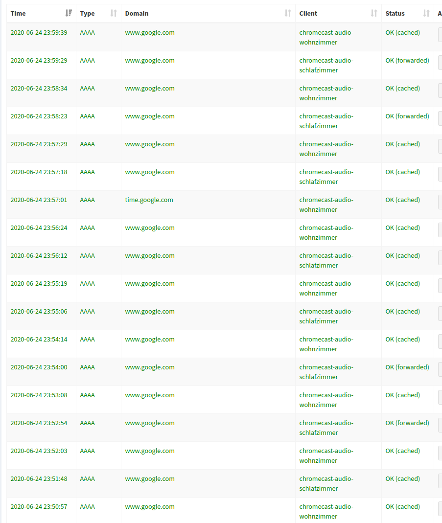

www.google.com has a TTL of 300 seconds, so 6300 x 5 minutes = 525 hours of continuous google usage since June 9th. That is pretty impressive. Or was this over an entire year (=whole database)? Even is so, this roughly means two hours of Google a day. It is not unrealistic in itself, however, maybe still a bit extreme.
No just since June 9th. Two chromcast devices...
Actual "usage time" was maybe 2 hours.
How does it look for the Google domain without sorting by status?

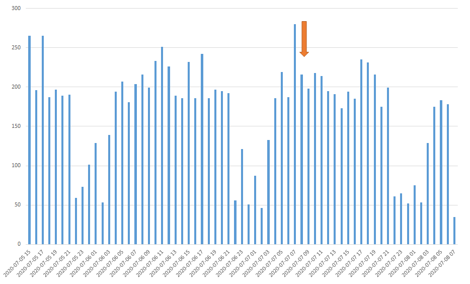

Blocking all AAAA queries for almost 24h now (since morning 07.07.2020).
I neither observe clients going crazy nor clients stopping queries AAAA records. They are just blocked, the amount of queries didn't change.
sqlite3  /etc/pihole/pihole-FTL.db -separator "," "Select count(domain), strftime('%Y-%m-%d %H',timestamp, 'unixepoch') from queries where type=2 group by strftime('%Y-%m-%d %H',timestamp, 'unixepoch')"
I think this is expected. IPv6 is to be preferred on the web for good reasons so you should always check if there is a way to connect via IPv6. If the system is lacking any IPv6 connectivity but is still doing AAAA lookups, then this could be considered a bug in the corresponding application.
