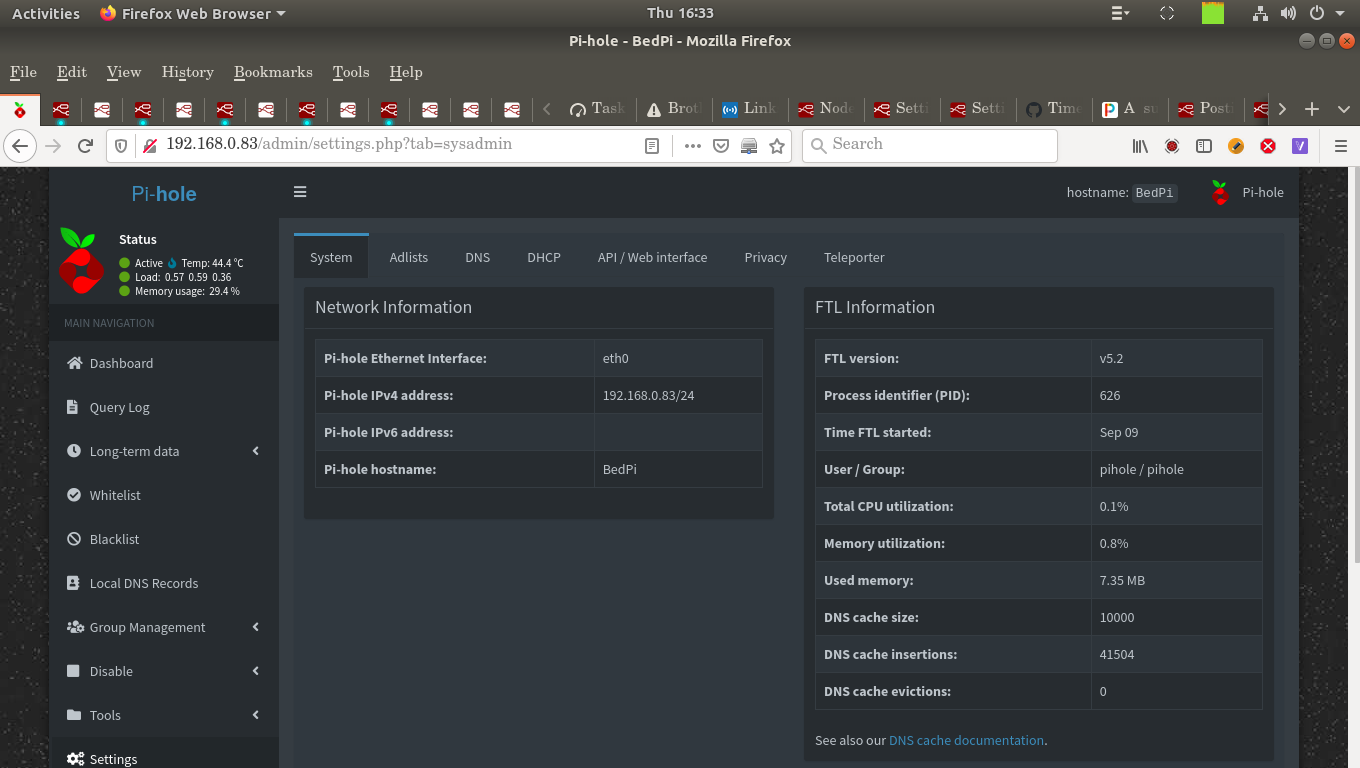

I was sent here from another thread I have about IPv6 addresses and me not having any IPv6 addresses.
So where is this: AAAA_QUERY_ANALYSIS in settings?

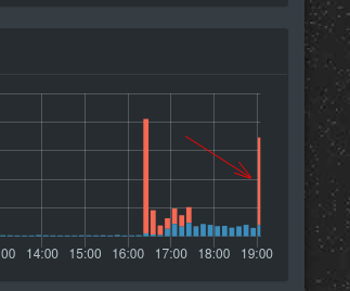

AAAA_QUERY_ANALASYS=no
That was done abut 17:00 local.
I turned the machine off there about and turned it back on on now.
Looking at the graphs, I don't think that is working.

(Not at you). I just edited the post and show the result of editing the file and setting it to no.
I accept that if I am running an IP(4) network it is going to cause problems with programs when they are told to use IP(6).
But the fact they are showing on the graph after I (hope/think) I set it to not do that is .... confusing.
Not a big deal. It is early days and in the long run I am sure this will be resolved. Just until then any information extracted from the graphs is skewed because of this also included.
