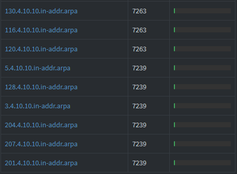

OPNsense is sending around 200k DNS querys per day to pi-hole and I dont even understand what OPNsense is doing or which configuration is responsible for this behavior.
This is a list of the permitted domains and I think these in-addr.arpa adresses somehow local adresses or something ?
As you can see these queries are a a huge chunk of the overall queries and I also see some error messages stating that pi-hole need to throttle opnsense.

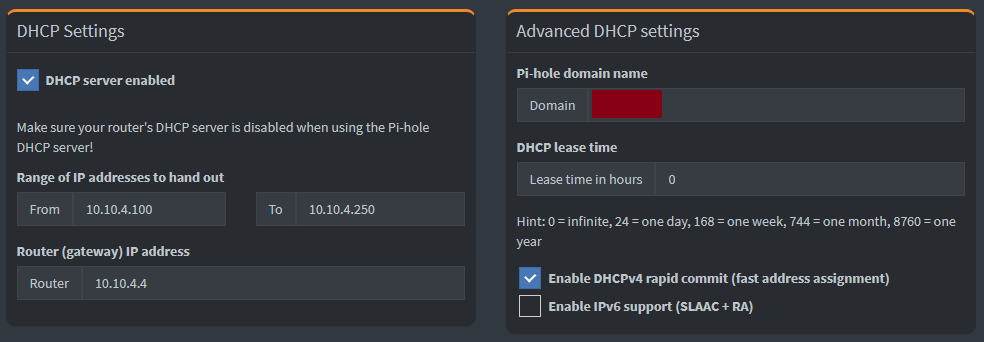

This is my DHCP config with domain set up.

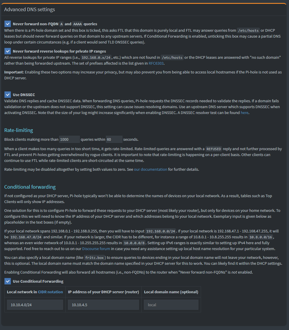

Advanced DNS settings:

I use OPNsense and don't see this behaviour. However, OPNsense handles my DHCP, I only use PiHole (with Unbound) for DNS.
If you are using PiHole for your DHCP, you wouldn't need Conditional Forwarding. Maybe this is the source?
