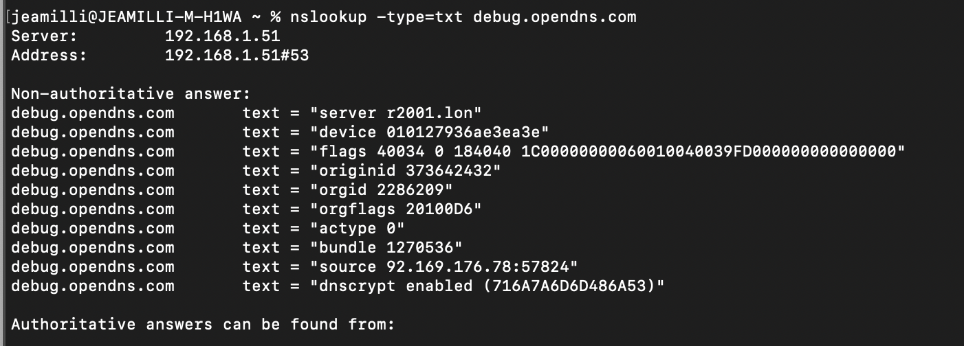

Unless all that volume is happening in a short amount of time (check your OpenDNS or Pi Hole dashboard), no. That volume should be fine. I'm pushing significantly more than that traffic through :slight_smile: Something to try (if you are still seeing REFUSED) is debug.opendns.com/TXT lookup (dig txt debug.opendns.com or nslookup -type=txt debug.opendns.com) Make sure originid is not 0. Otherwise, I'd suggest a ticket. If you are a Cisco Employee, there may be some additional contacts you can reach out to. A couple of us that work on the resolvers run pi-hole at home (we even modified FTL for a hack-a-thon project to embed device id.) I'll shoot you a PM.

Here is the output of the requested command.
