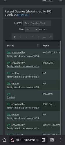

As upstream DNS I set the OpenDNS family shield IPs:
  • 208.67.222.123
  • 208.67.220.123
And I think I did that right, because the query log shows:

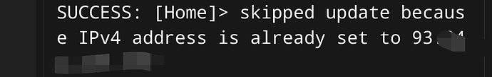

At the same time, I set dyndns with a ddclient also under docker compose.
This also seems to work. Ddclient log shows
And when I login to OpenDNS, the IP there is the correct one.
