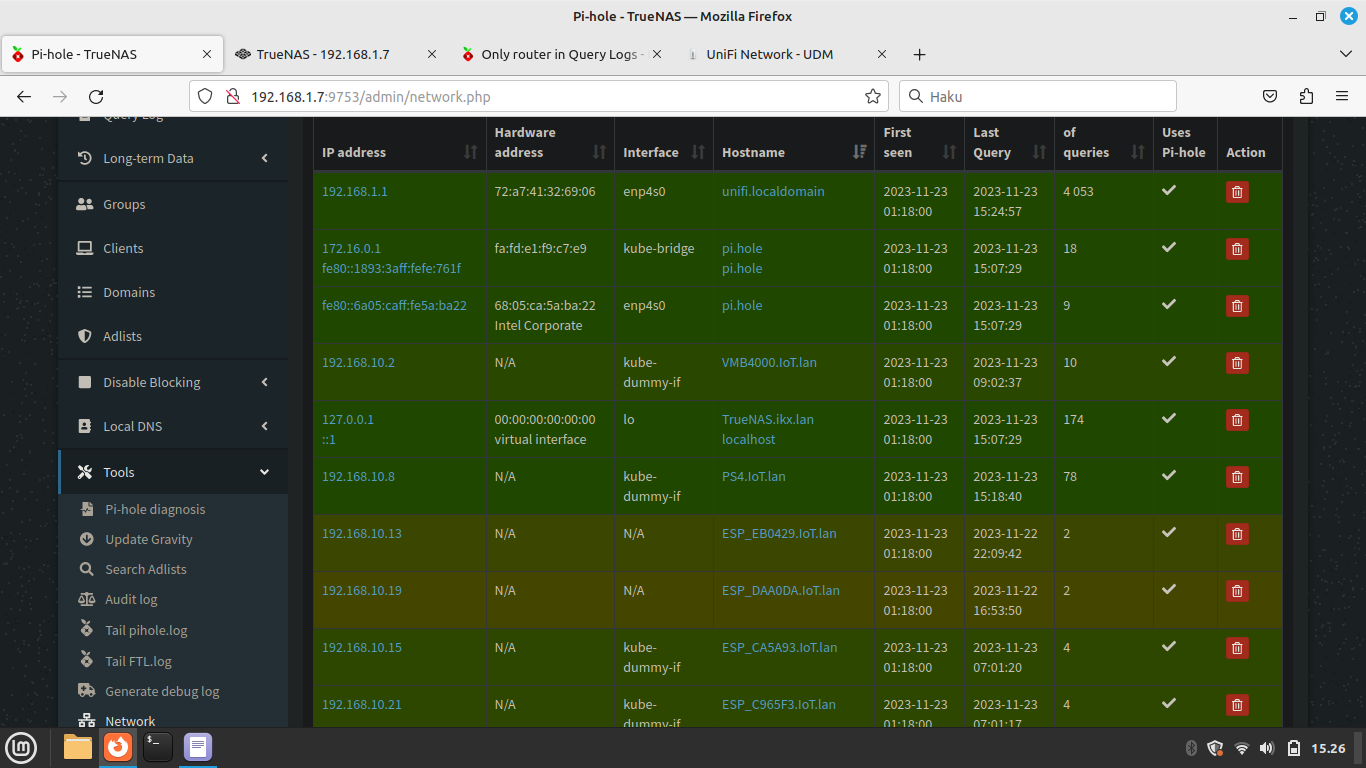

Only router in Query Logs
Queries from individual Lan clients should show up in Query Log.
I have seen this question asked before, but none of them shows that the DNS IP in clients is accually the piholes (192.168.1.7).
PiHole runs on TrueNAS Scale.
I have UniFi UDM as a router where I have set Pihole as DNS server. I have multiple VLANs.
I have seen actual clients in Query Log earlier in this exact pihole installation. Nowdays its only the router with hostname "unifi.localdomain".
Query Log shows only router making queries to the pihole.

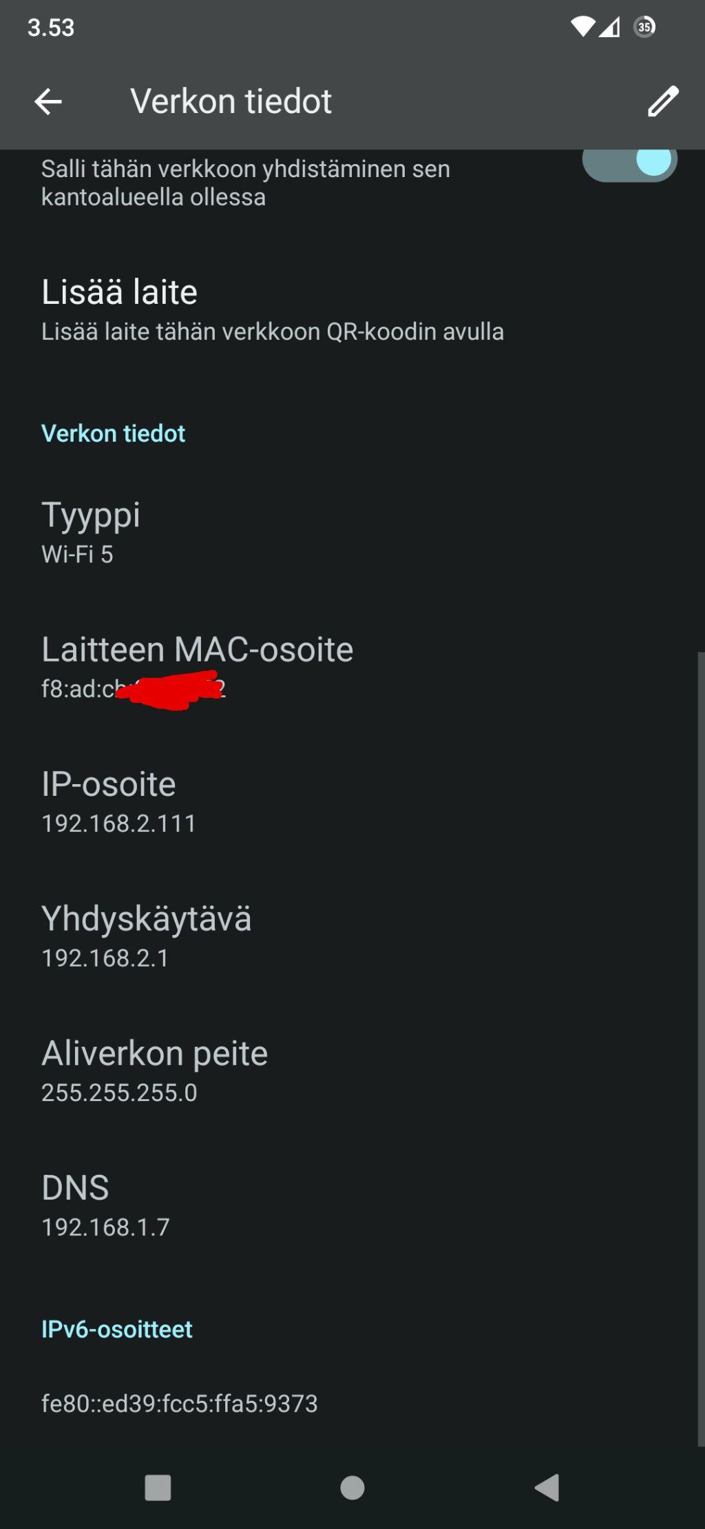

Im not questioning what you're saying, but how is it possible that clients tell the DNS server to be the PiHole (1.7) if DHCP server is telling 1.1, like in the picture? I checked also my Windows 10.
I'm not sure, I'm just going by what the DHCP scan found in the debug log. Is there something specific to this setup which would present different settings to the clients vs the Pi-hole?
Aha! I found it out, as I said I had different VLANs in my network, i have forgot to set the 192.168.1.0/24 subnet to use pihole as it's DNS. I changed it.
However this wouldn't explain why on 192.168.2.0/27 subnet devices which know DNS to be PiHole, are not showing on the client list in PiHole... Very strange..

I just happened to notice that Client Activity graph shows many clients at 22.11.2023 19:00 - 20.00. How some clients are showing but not others are not? :open_mouth:

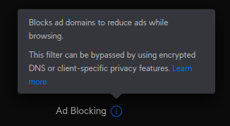

Ubiquiti has introduced ad blocking option by themselfs. It seems that they redirect DNS traffic via their adblocking daemon and then to PiHole.
(Learn more directs you to: UniFi Gateway - Ad Blocking)
Disabling this option returned the clients to use directly Pi-Hole. I also verified it.
