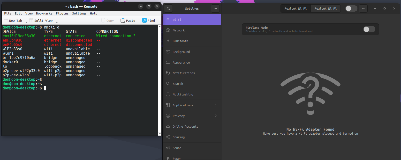

  1. This is first screenshoot with all wifi off and cabels (beside from phone), and what konsole shows:

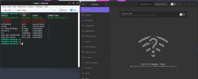

  2. Next screen presents truning all network on and the outcome in konsole (witch is dublicated 13 times:
Doubling in wifi secion i saw few days ago, so this maybe have nothing to do with this. For now. I uninsllled Pi-hole with addicionals and tried turning of router for 30 mins. Nothing help. I really need to mess up bad in router configuration so i cant even go back then, and turn DTSHC on (I dont even know how i leave it).
