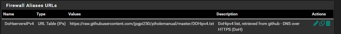

In PFsense, I have some time ago made a DoH rule that blocks DNS over HTTPS. It is a list that is updated continuously.

The most common approach to block DoH would probably be to block a list of known DoH servers, either by IP or by domain.
If you follow that approach, you should probably check your DoH lists whether they would accidentally contain firebog.net domains and/or IPs.

doh-ipv4
Instead of allowing firewall clients to bypass your DoH rule, you could consider to either remove those IPs from the list, or explicitly allow them in your firewall.
