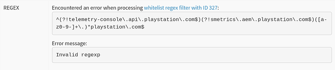

^(?!telemetry-console\.api\.playstation\.com$)(?!smetrics\.aem\.playstation\.com$)([a-z0-9-]+\.)*playstation\.com$
Pi-Hole happily accepts this and it seemed to work.

If you follow both links, you'll see that in both proposed regex rules, domains like feature.api.playstation.com are actually included. However, Pi-Hole still blocks them. When I click on the reason (see picture), it links to the . regex blacklist.
This could mean that Pi-Hole interprets the regex whitelist differently than regex101.com. For some reason, it's not including any subdomain of api.playstation.com. Checking Pi-Hole diagnosis, I see:
Is this intended?

The Pi-hole regex accepts only a specific set of regex rules. It is fast, but it doesn't accept some grouping rules (like you used above).
From Pi-hole docs:
We implement the POSIX Extended Regular Expressions similar to the one used by the UNIX egrep (or grep -E) command. We amend the regex engine by approximate blocking (compare to agrep) and other special features like matching to specific query types only.
This makes very hard to block everything, then "unblock" a domain, but not its subdomains.
