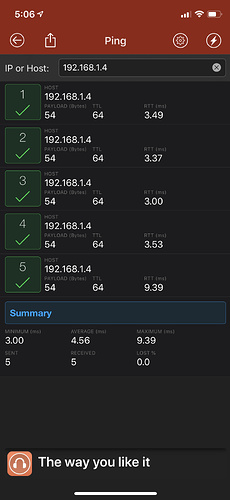

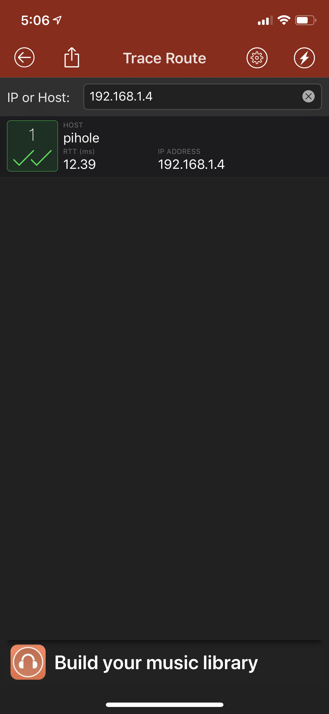

I've a Mikrotik Hex S and a few POE network switches, I setup PiHole on a RPI2 hard wired to a port on the router and updated the DNS servers to ONLY include the PiHole static IP. I am using the router as the DHCP server. If I plug either WAP (EAP245) into a long run with an unmanaged POE switch, I get internet access on any device connected to it. If I plug either WAP into the HEX S directly through a POE Injector, devices connected to that WAP do NOT have internet access. I've swapped the WAPs, replaced cables, swapped injectors, even tried another POE switch.. I cannot get both WAPs to provide internet access while the PiHole is setup. While connected to the "no internet" WAP, I can visit the PiHole admin page. Any suggestions before I plug it back up and try again? I'm running low on WAF and need a plan of action prior to re-enabling PiHole.

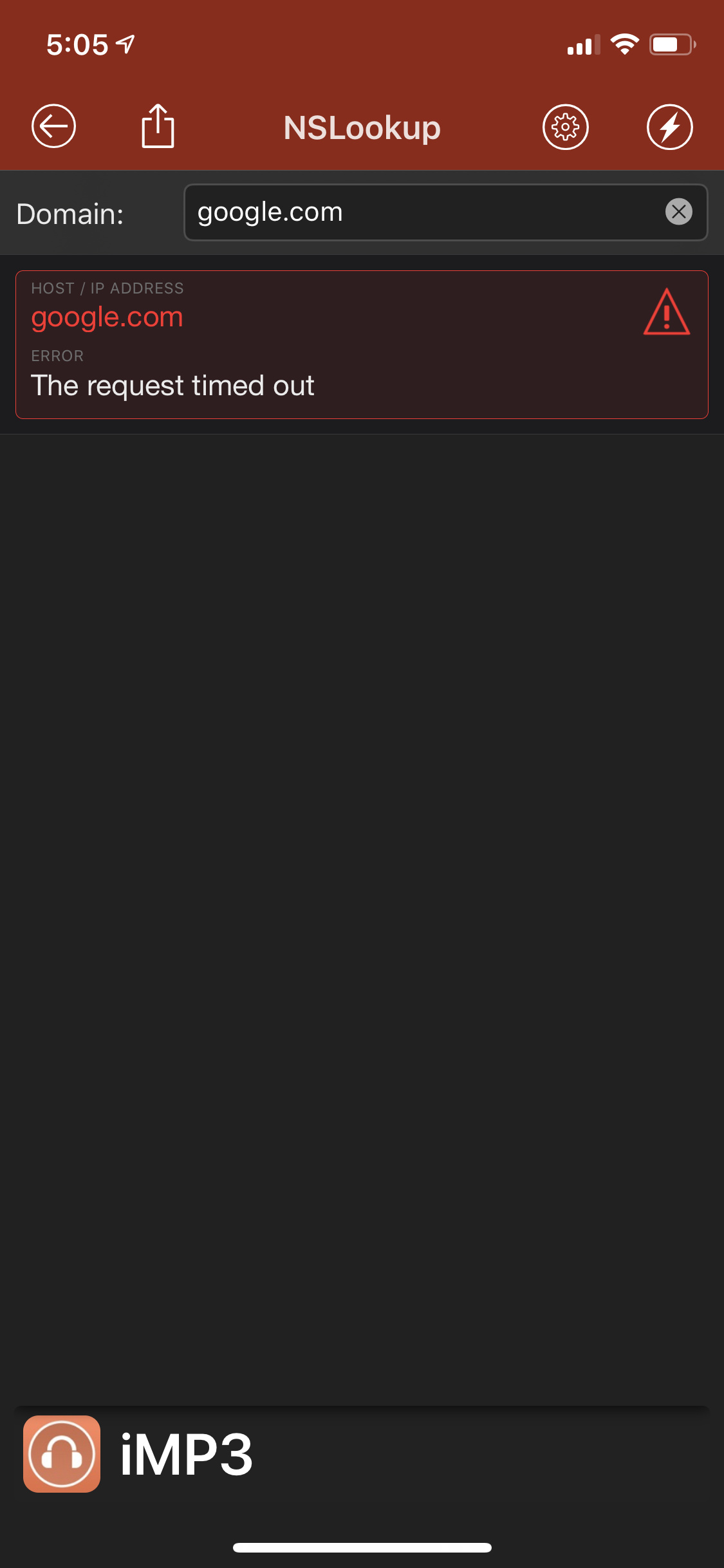

What's the output of the nslookup command on the client that's connected to the non working AP ?

NSLookup had to be via iOS App, since I only have desktop PCs and they're all wired (some to each of the two POE Switches) Everything is working wired as well.
