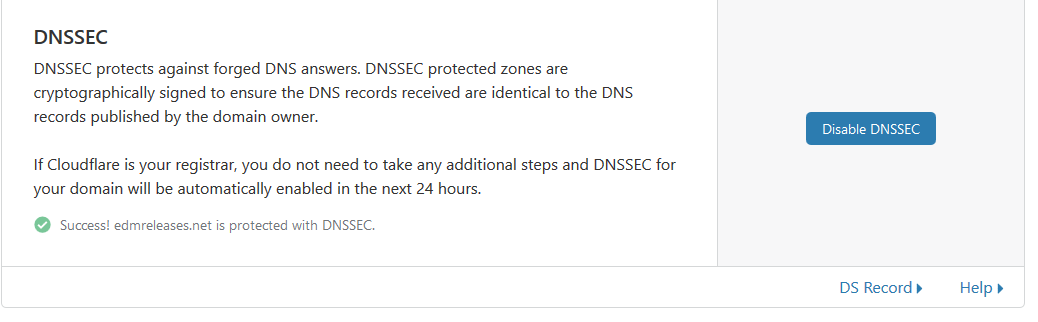

What does the CloudFlare panel show under DNSSEC?
Cloudflare looks happy.
Have a look over https://support.cloudflare.com/hc/en-us/articles/360021111972 and run through the steps.
with dnssec on pihole enabled or disabled?
Should work with it enabled for everything to pass.
And it seems like it just worked this time after enabling DNSSEC for some reason that I don't understand.
All tests give expected result. shall I post here?
If it's working it just may have been a cache issue on the CloudFlare resolver you were being routed to. No need to post the results here if things are all working.
