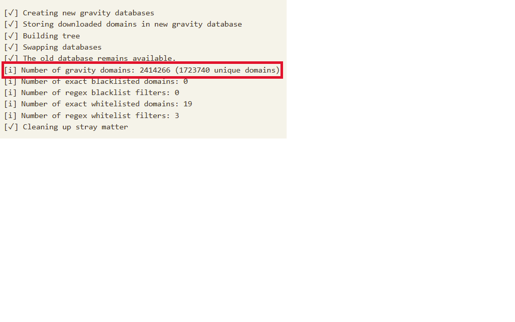

Updated the docker image to latest, ran a gravity update and update process showed success but the list of blocked domains on the main banner didn't change. Re-ran gravity update, all lists showed current but again banner number of blocked domains didn't change.

I have custom lists for over 1M domains, it still shows the default 137,000 ish

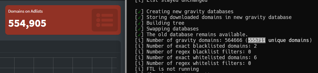

What is it you are expecting to see? Does the number of domains on the web interface differ to that of the gravity output? Please provide screenshots of both the dashboard and gravity output
OK, we're getting closer - this information would have been useful to start with ![]()
I can confirm a difference on my own setup (not quite so many domains)
Investigating...
Thank you, sorry for not posting that upfront. Let me know if you need any other info.

It's fixed as a side-effect of Fix pihole restart command by yubiuser · Pull Request #4899 · pi-hole/pi-hole · GitHub
For a detailed analysis have a look here:
https://github.com/pi-hole/pi-hole/issues/4900#issuecomment-1238674254
Workaround is a restart of DNS resolver at web interface
Yup, that's what I've been having to do every time lately.
