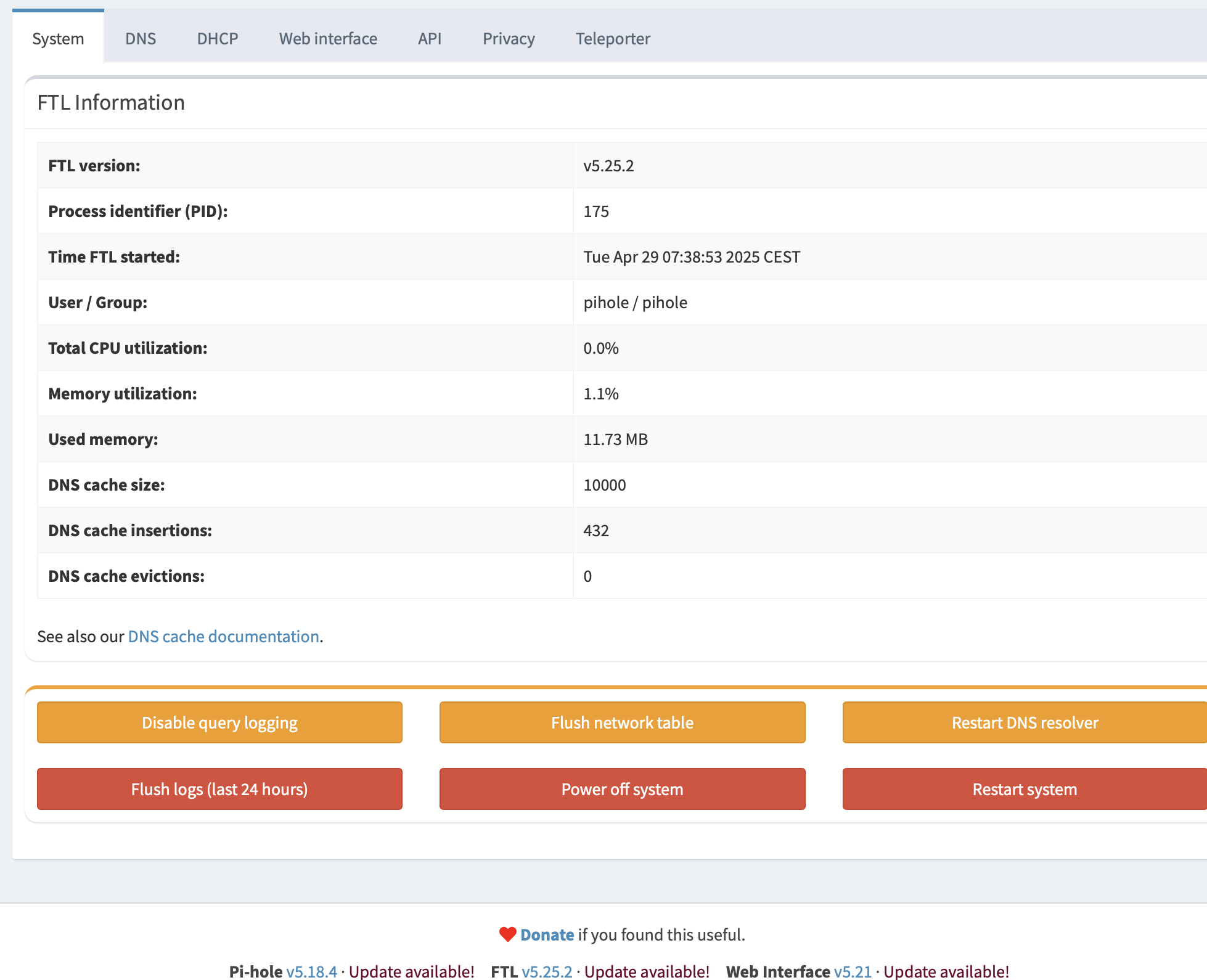

Hi everyone, I've been installing pihole du proxmox as LXC for years. In the latest version I can't upgrade because when restarting a denied access error to the ntp.
I wanted to know where I can find the parameters to disable the NTP sync. My version is * Pi-hole v5.18.4 .
Dall'immagine del setup non trovo la voce ntp ...
Pi-hole v5 did not offer NTP support.
Your screenshot suggests you are still running Pi-hole v5?
I m afraid to yes

With Pi-hole v6, you may disable the NTP server by running:
sudo pihole-FTL --config ntp.ipv4.active false
sudo pihole-FTL --config ntp.ipv6.active false
And to disable the NTP client:
sudo pihole-FTL --config ntp.sync.active false
Of course, you'd need Pi-hole v6 installed to run those statements.
