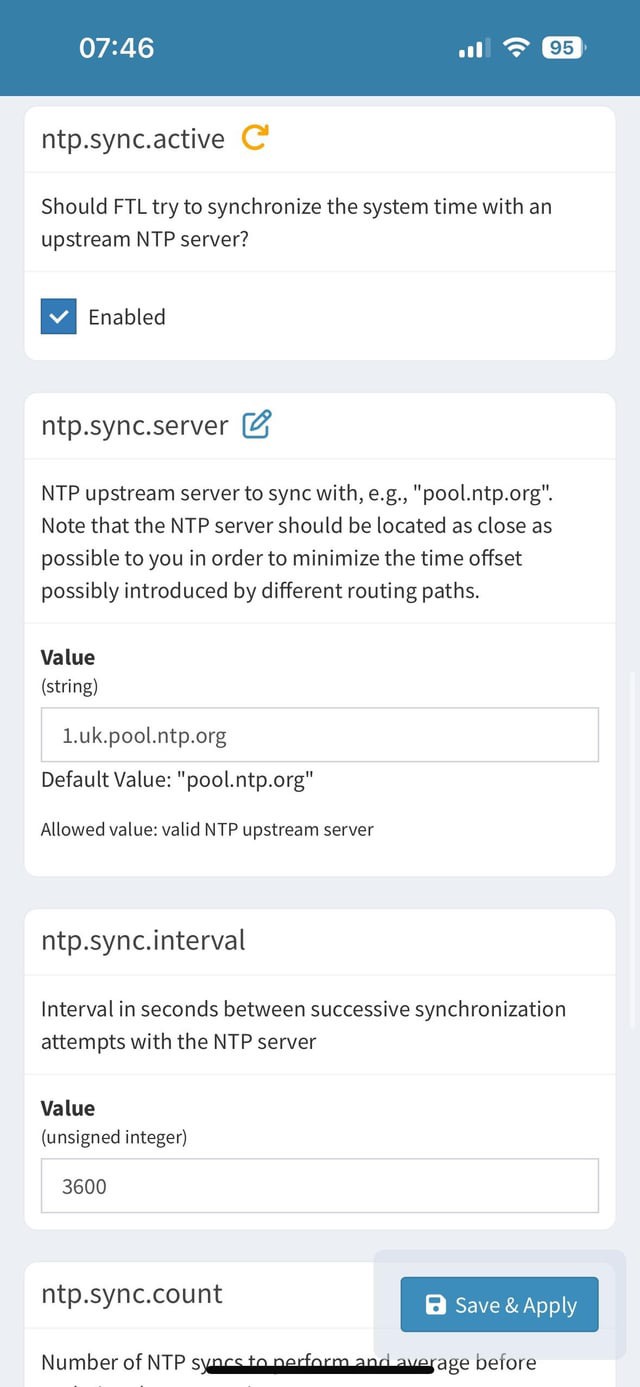

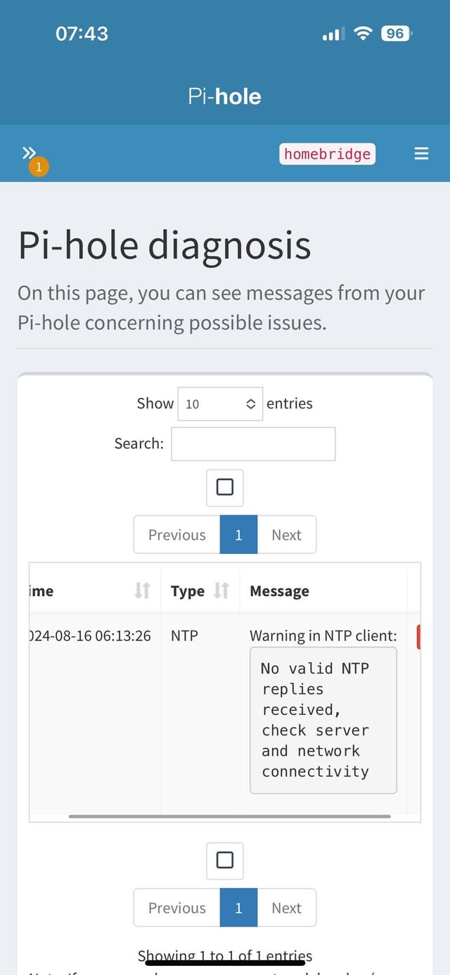

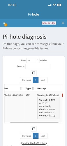

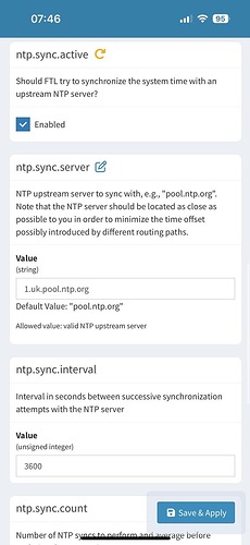

Using latest Pihole beta, and keep getting this NTP error! Just no idea how to fix. Pihole is plugged into a TP-Link switch which is plugged into a UDM Pro. The switch is getting time fine from NTP servers. Why is the Pihole kicking up a fuss!?

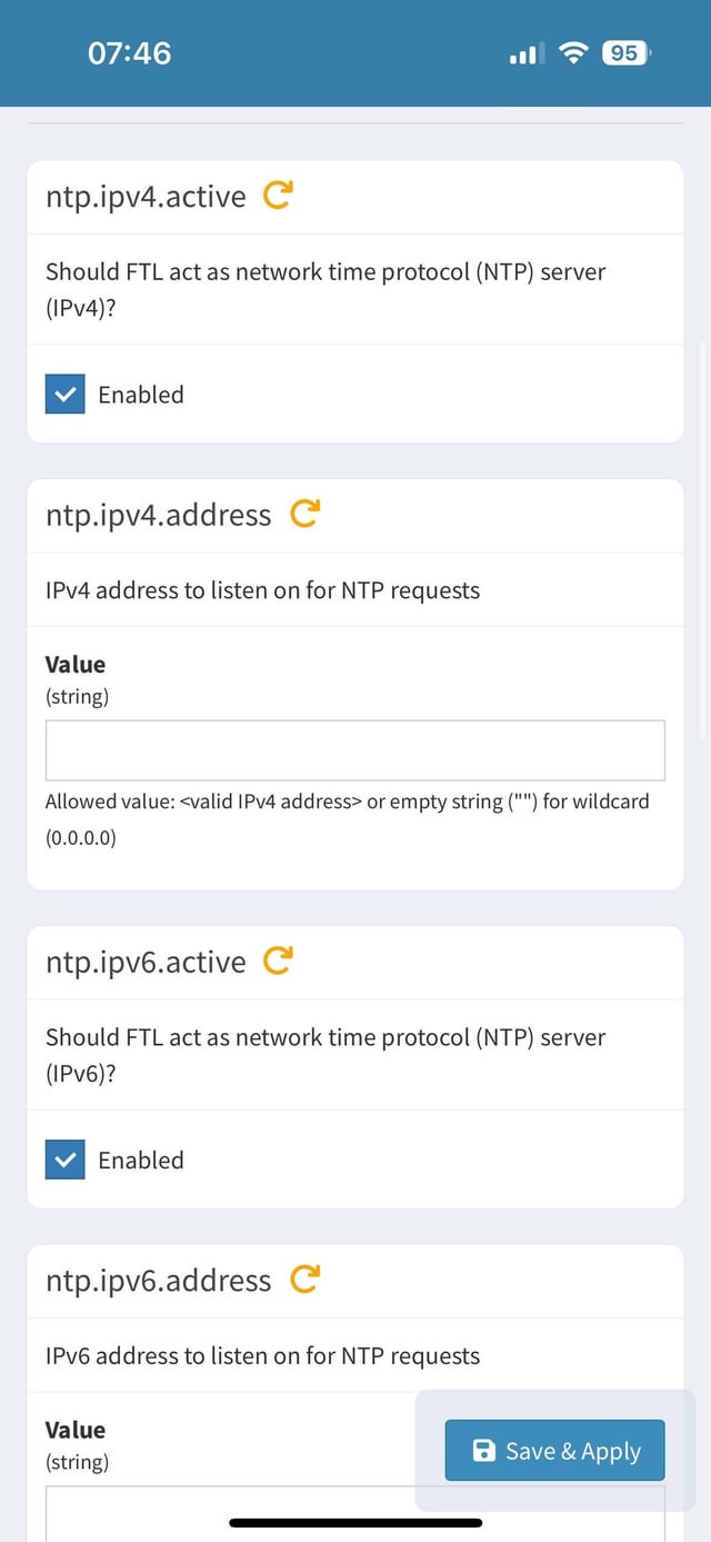

Attached screenshots of my settings too. I’ve tried pool.ntp.gov instead of uk.pool and same problem.

This shows time synchronization with 1.uk.pool.ntp.org worked in your testing. Following your configuration, your Pi-hole is trying to sync its time every 3600 seconds (once per hour) - could it be that you haven't had Internet when this warning was generated?
Could you also test whether the warning re-appears after manually deleting it? If so, does it immediately reappear (within one hour after deleting it) or does it take longer to reappear?
Haha that’s odd! It was installed on the Homebridge config menu, and then immediately updated to the V6 beta branch. It seems to be blocking and doing unbound ok. Is those errors something I should be concerned about and need to fix?
I can delete the error message and it might come back next morning or might not even come back till a week later.

No and from your description
it really sounds like to be generated because the server is not reachable at times from your Internet connection. Nothing really to be worried about.
