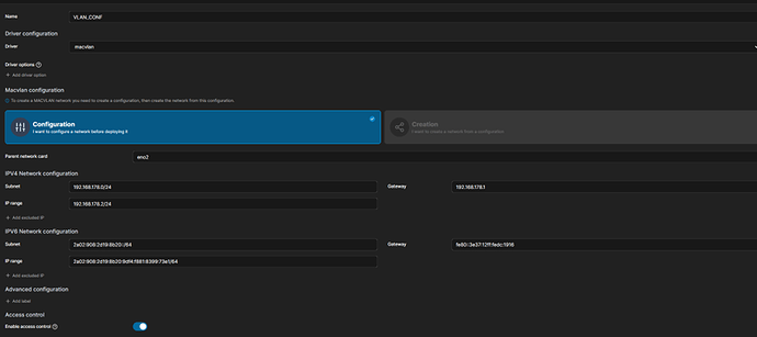

I created a virtual network in Portainer for the past without an IPv6 Gateway.
The problem is, when I enter my IPv6 Gateway and the Subnet I am getting the following Error code:
That are the settings I have tried to use:

In general, you should avoid using a GUA address for Pi-hole.
Pi-hole needs a fixed IP, and with a GUA IPv6, the prefix as well as the interface identifier are likely to change.
By default, Docker is IPv4 only.
If you want IPv6 for a container, you'd have to enable that for Docker's daemon in general as well as for a specific container.
Your observation would suggest that communication between your host OS, the Docker daemon and the container isn't frictionless.
Also note that Docker's IPv6 support could have been breaking network isolation in the past.
It seems Docker tried to address this in the meantime, but it may yet be considered experimental, as explicity allowing some experimental features is recommended by Docker, see https://docs.docker.com/config/daemon/ipv6/.
But I would recommend to forego IPv6 for Docker altogether.
