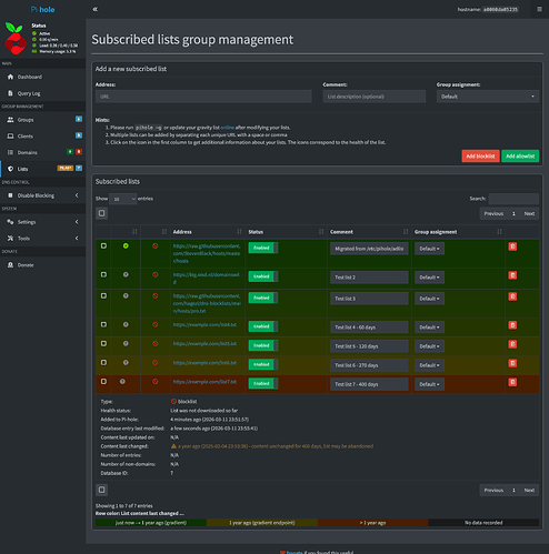

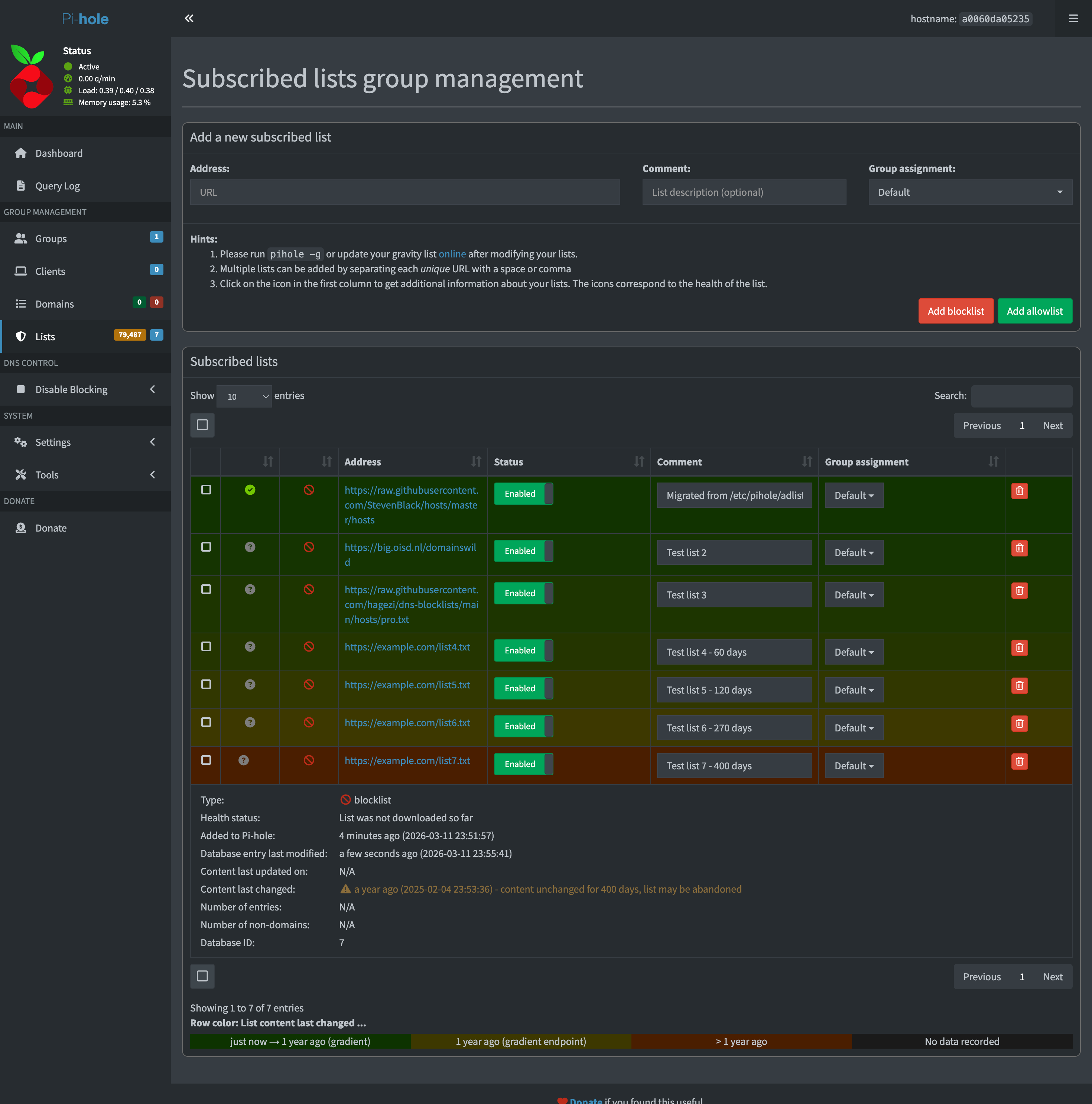

Long time Pi-hole user, first post so apologies for diving straight in with this, saw the thread awhile back and went down a rabbit hole. It’s a concept, working on Docker on my laptop.
Follows the same heatmap pattern as the network table. Tracks when content actually changes so 304s and unchanged re-fetches don't reset the clock. Spans all three repos.
Is this the sort of thing people are looking for?
That is more or less what I would want to see as the completed feature.
A bump to prevent this from closing as this feature request would be helpful.
@lewys this looks good. Most of the data is already there: date_updated only moves when gravity sees the list content actually change (a 304 or an unchanged checksum leaves it alone), and the list details already show it as "Content last updated on". So I think this can be a web-only change, coloring lists by the age of date_updated like the network table does.
With a small team of volunteers, we pick work mostly by votes weighed against complexity, and a PR is the fastest way past that. Please open one against the development branch of pi-hole/web, I am happy to review it.
