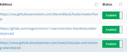

U channels and Channel5 stream normally here but then I am using a different choice of domain lists. You can either work with your existing choice and try to find the domain blocking streaming or look at using a different list.
Do you have a URL for your list? Maybe I can use that too.
