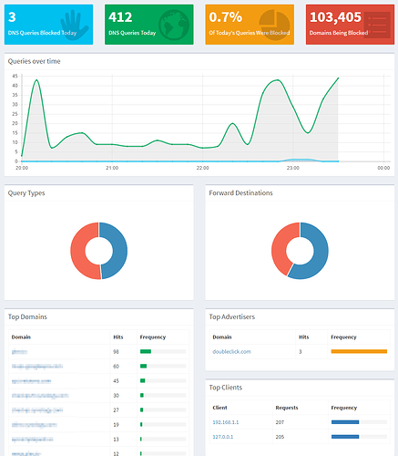

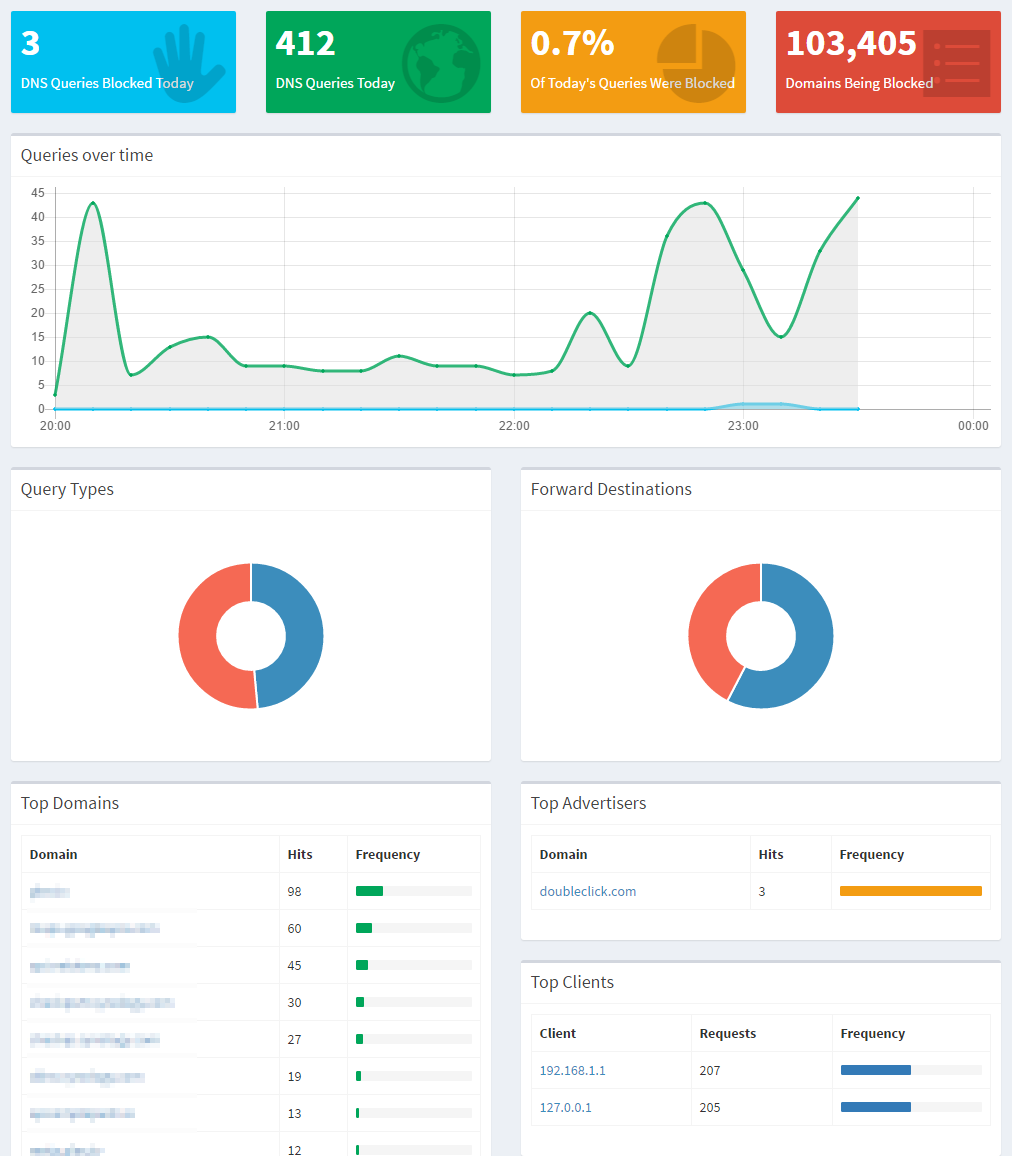

Screenshot from admin site that is running perfectly well.
Only ad that is getting blocked are the one that is made during the "pihole -d" command (doubleclick.com).

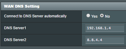

This are my DNS settings on the router:

Remove the secondary DNS server, what is happening is that your queries are going to the secondary and bypassing the Pi-hole altogether. That's why no log entries were captured, no queries were sent to the Pi-hole when you were browsing.

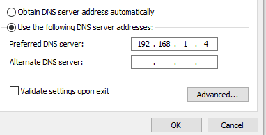

Got it working now. Some how I had to set the DNS server IP manually for my LAN connection. "Automatically" did not work as expected. The Win10 PC has this setting now:
Should'nt the PC ask the router for what DNS server to use when it is set to "automatically"? On my router Primary DNS is set to 192.168.1.4, which is the adress to the ubuntu server that is running PI-Hole.
Got it. Stupid me managed to change the WAN DNS server instead of the DHCP DNS on the router. Now everything is working as a charm! Cant thank you enough for your kind support, DanSchaper :slight_smile:
