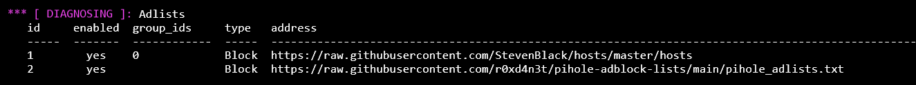

Your debug log shows there are 2 lists, but only one (the default) is assigned to a group:
The second list has no group_ids. This means this list is not used.
You need to assign this list to the Default group.
If after changing that you still see no blocked queries, please post the compose file (or docker run command) used to start the container.
