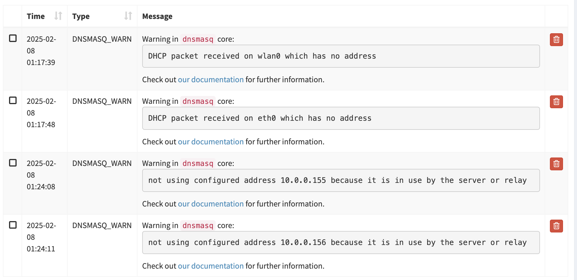

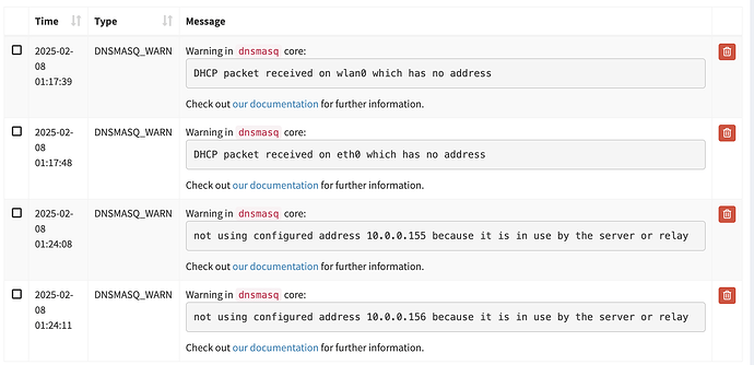

These are the only diagnosis logs at this time:
DHCP packet received on wlan0 which has no address
DHCP packet received on eth0 which has no address
not using configured address 10.0.0.155 because it is in use by the server or relay
not using configured address 10.0.0.156 because it is in use by the server or relay
