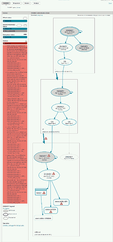

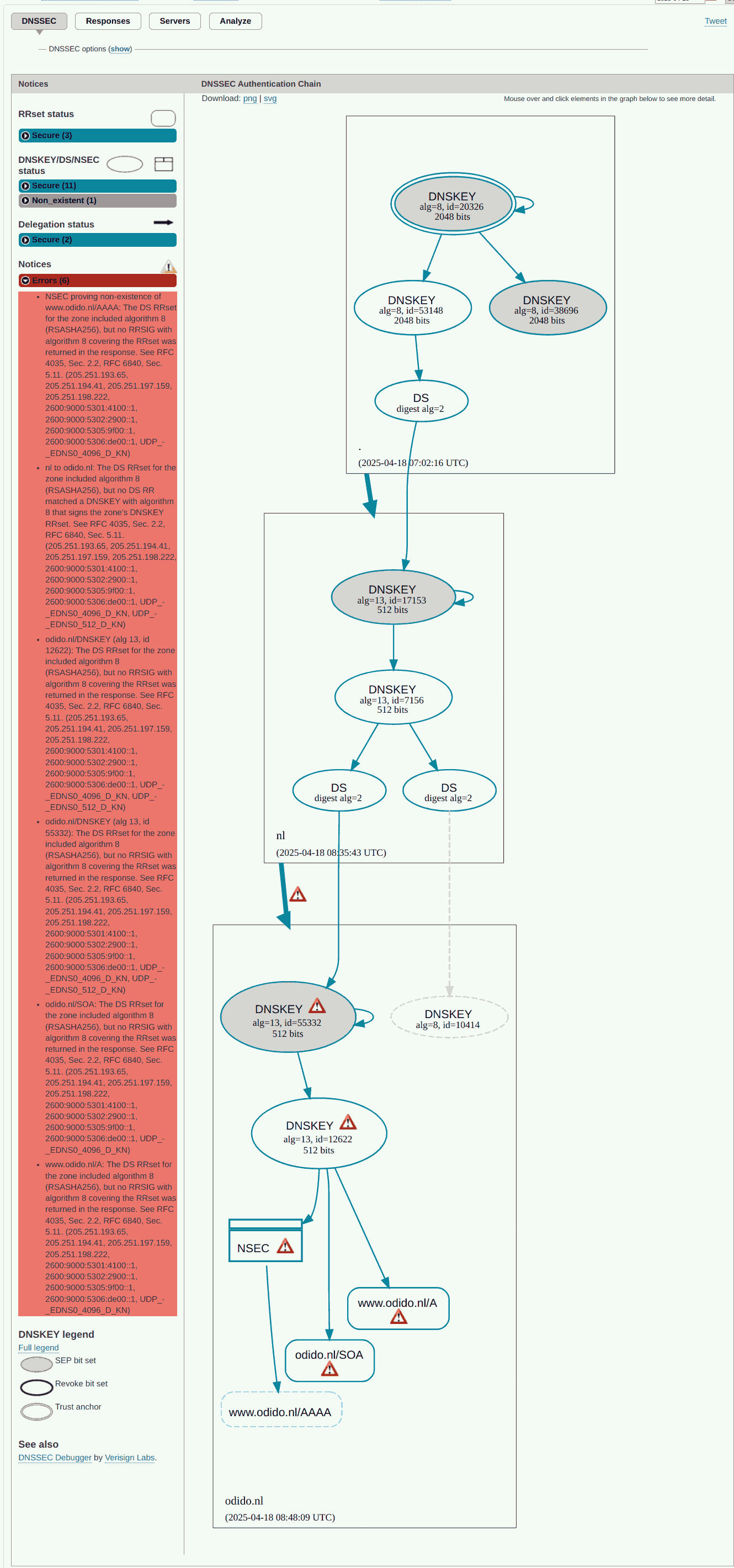

www.odido.nl's zone configuration seems faulty. Apparently, it is announcing support for a specific signing algorithm, but not supplying actual data:
Likely, that incorrect configuration results in unbound failing to validate signed DNS records for odido.nl via DNSSEC.
This has to be fixed by the domain's maintainer.

Thank you. Not sure I understand that picture, way over my head I guess :slight_smile: If I understand correctly, this would effect all Odido customers who also use Unbound, right? With around 8 million customers I should be able to find others with the same issue then, I'll see if I can find any.

As that domain belongs to your ISP, you could approach your ISP with the findings of DNSViz's DNSSEC validator, by including the link I've posted above, and ask them to address the errors it found.

So, I did find a forum thread with others who have that same issue starting back from april 17 2025, confirming that DNSviz report. There, solutions are provided with a change in unbound.conf: 'harden-algo-downgrade: no' that would effectively mean something like 'if alg 13 is okay then ignore alg 8'. And then the thread continious with lots more changes that I don't understand :rofl:
