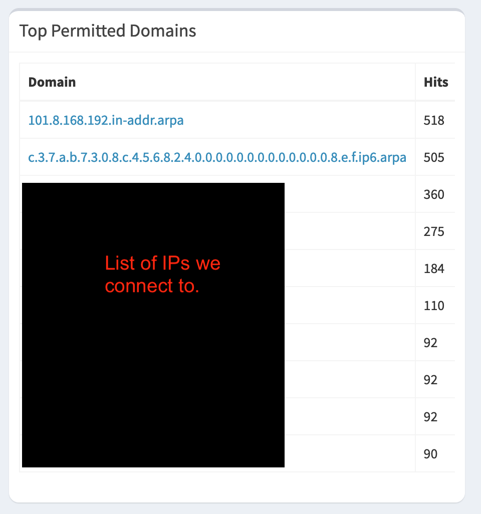

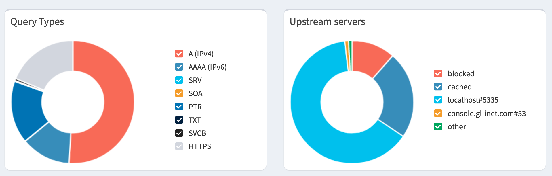

I would expect to see requests blocked, requests cached, and requests sent to Unbound. I would also expect to only have IPs of services accessed.

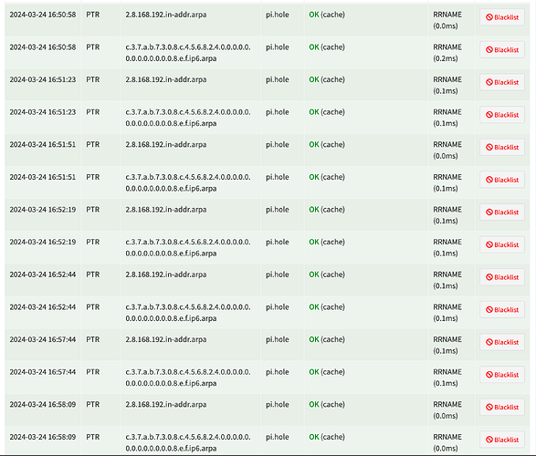

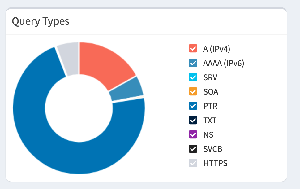

In practice, however, the dashboard also lists my router and an "other" category, and there are apparently numerous reverse DNS requests (IPv4 and IPv6) for the IP of the Pi (192.168.8.101 is the Pi's IPv4 address and I guess, but could be wrong, that the IPv6 address is also that of the Pi; it starts with fe:80 so it should local, right?).
Is this normal and expected, or is something not set up properly?

This is normal.
There are some DNS queries which are neither sent upstream nor are they cached or blocked (like local SERVFAIL, or some queries used to probe which upstream is the fastest).
If these queries are ignored in the pie chart, it will cause a mismatch on the calculated blocked percentage compared to the value reported at the top box.
You are using Conditional Forwarding.
This is actually forwarding local queries to your router and the chart is showing these queries.
Yes. Your debug log confirms this is the case.
Local queries also show up in the graphics and tables.

What exactly are those local queries for? And should they be using IPv6? Is it normal to have so many reverse DNS lookups for the pi?
See this post for an explanation.
They are queries made by Pi-hole itself (pi.hole), and by the OS on which Pi-hole is installed (localhost) if that OS is using Pi-hole (ie, itself) for DNS. They will use IPv6 if IPv6 is available to use, for example if the Pi-hole's OS is running it and other clients on the network are too, especially if the router supports it and it is enabled there.
Yes, especially if conditional forwarding is enabled. Nothing to be concerned about.

Sorry, maybe I wasn't clear. I mean mean to turn it off entirely, I meant more the constant quizzing of pi-hole for local IPv6 addresses. It feels like the local network could do without IPv6, if that makes sense.
And IPv6 requests are off the chart..
