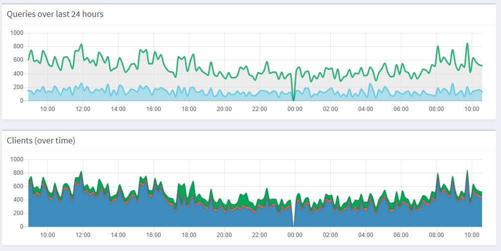

I have my pi-hole hosted on DigitalOcean (extremely firewalled of course). I submitted a ticket to Digital Ocean and of course they said that there was nothing abnormal on their end. Is it normal for pi-hole to have a period of ~10 minutes from 23:50-23:59 of 0 queries? My pi-hole handles 2 sites: my regular office with ~10 PC's and various other internet connected devices & my home office with 1 PC and ~3 internet connected devices. Pi-hole is functioning perfectly and I love the program, it's just alarming that every morning I come in and check the activity on the web interface and find that it appears that pi-hole has gone down for 10 minutes at the same time every night. Is this a normal pi-hole behavior? Or should I press this issue further with Digital Ocean?

See attached. I find it a little odd that there are multiple queries both before and after this 10 minute window. I have not checked the raw log as of yet this morning, once I do I will update.
OK. I took a minute and checked the log. It appears as though this may be a bug in the graph? There's plenty of activity going on between 23:50 and 00:00... Funny thing is now that I've opened the log file and inspected, the web interface graph shows correctly.
After watching this for a few more days, I'm convinced that the graph is the issue. The logs show that there is activity happening during this time period, but every day the graph still shows a drop to 0. I've tried reading the log to try and fix it like the other day but it hasn't worked since. I guess we can consider this resolved, but as we all know pretty graphs are pretty.
I think this will get fixed as part of FTLDNS @DL6ER?
Yes, that's true. This a bug in FTL caused by a small glitch when interpreting the logs. As FTLDNS does not analyze logs (which are affected by nightly flushing), this problem vanishes altogether.
