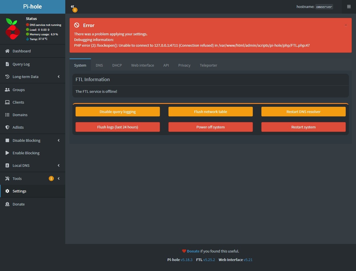

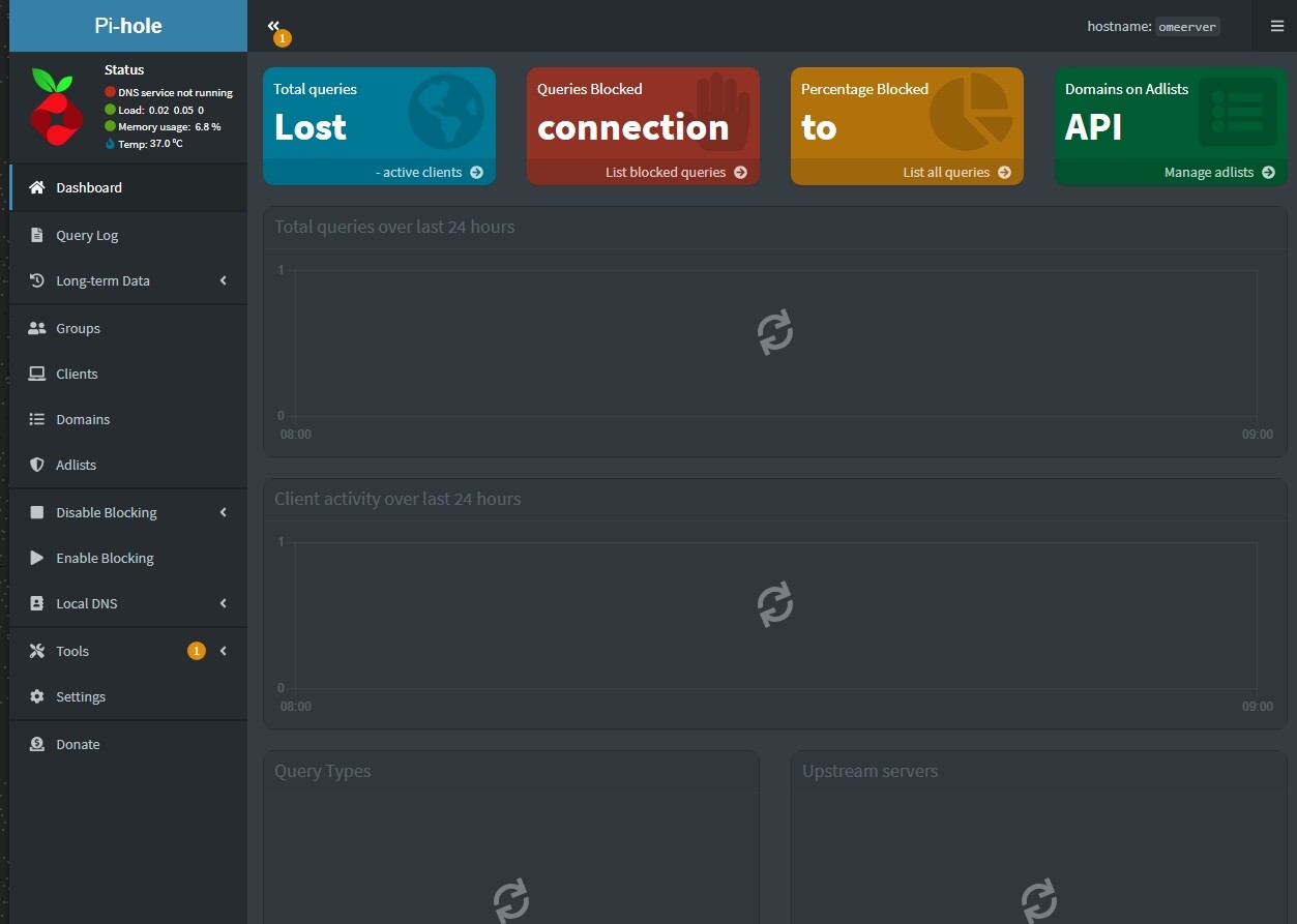

Actual Behaviour: I can connect with Putty but I'm really a noob to a lot of this so i know it's probably going to take several commands to fix this.
Debug Token: https://tricorder.pi-hole.net/ORtLCJEw/

According to your debug log, you are running Bind9's DNS server named:
[✗] udp:192.168.0.3:53 is in use by named (https://docs.pi-hole.net/main/prerequisites/#ports)
Bind9's DNS server can be configured to run as recursive or authoritative DNS server, so if you really want to run a recursive resolver, named may have gotten you halfway there.
But as both named as well as Pi-hole must claim port 53, only one of them would be able to actually do so.
If you prefer to run Pi-hole, you should disable and/or uninstall named, or move it to a different port.
The latter may allow you to run named as Pi-hole's only upstream DNS server, allowing you to combine Pi-hole's filtering with running a recursive resolver yourself (provided named would be configured as recursive resolver).

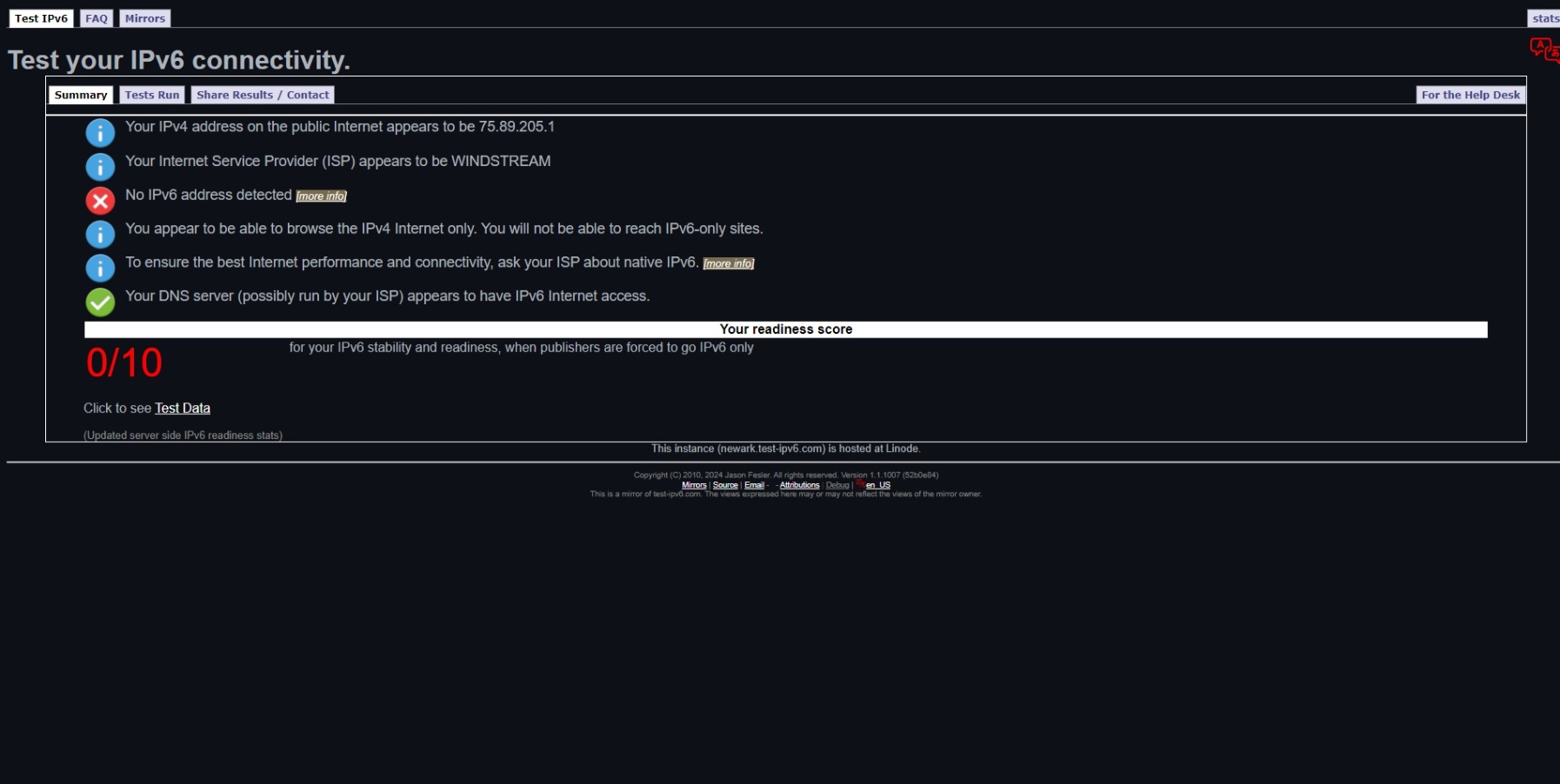

Oh I forgot to ask, before you disable IPv6 and when browsing to below link, does it show IPv6 being supported upstream by your ISP?
as for theIPv6 i believe its all disabled

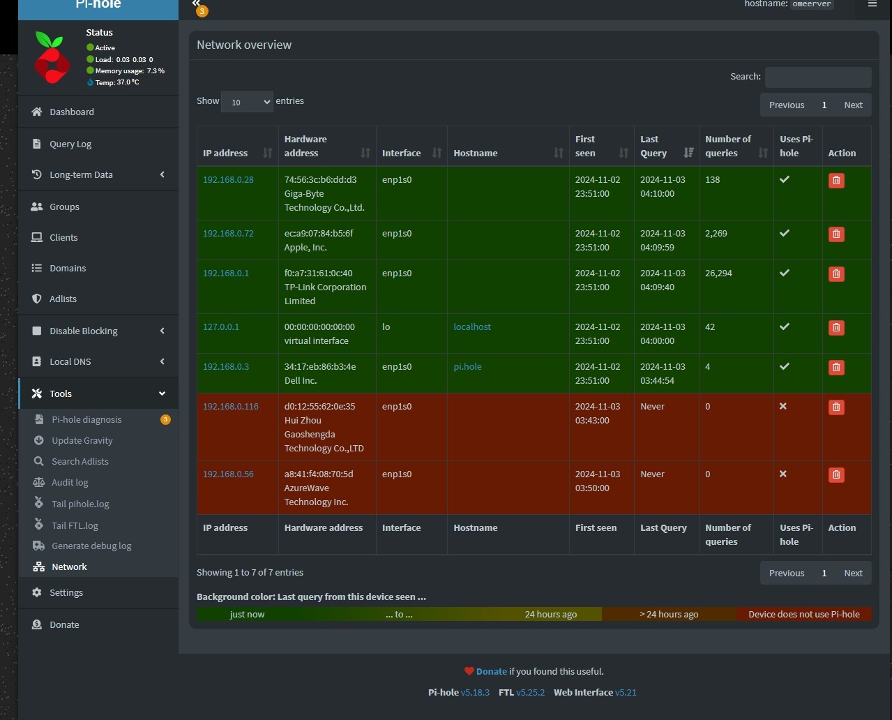

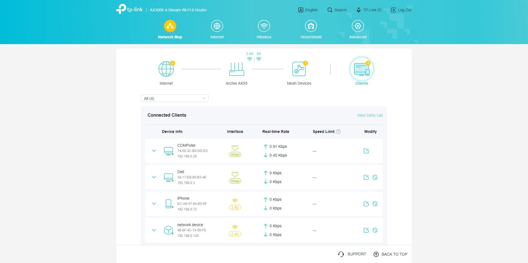

So um only devices I have on my Internet are my iPhone, PC, my device with the Pi on it, so what is all this??

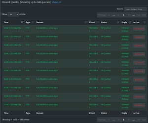

EDIT: I restarted DNS resolver and just have the rate limit showing but i now have a reverse DNS every second on my logs for 192.168.0.3 and I would love to get this fixed :slight_smile:
I dont know what those devices are.
Those IP's and MAC's in the "Network overview" are sourced from the OS ARP cache/table via neighbor discovery:
$ arp -n
Address                  HWtype  HWaddress           Flags Mask            Iface
10.0.0.5                 ether   00:16:3e:XX:XX:XX   C                     eth0
10.0.0.131               ether   00:16:3e:XX:XX:XX   C                     eth0
10.0.0.11                ether   00:1e:0b:XX:XX:XX   C                     eth0
$ ip neighbor
10.0.0.5 dev eth0 lladdr 00:16:3e:XX:XX:XX STALE
10.0.0.131 dev eth0 lladdr 00:16:3e:XX:XX:XX STALE
10.0.0.11 dev eth0 lladdr 00:1e:0b:XX:XX:XX DELAY
You could try ping each address on the Ubuntu host with below and depending if it replies, start switching off devices to see when the replies stop :wink:

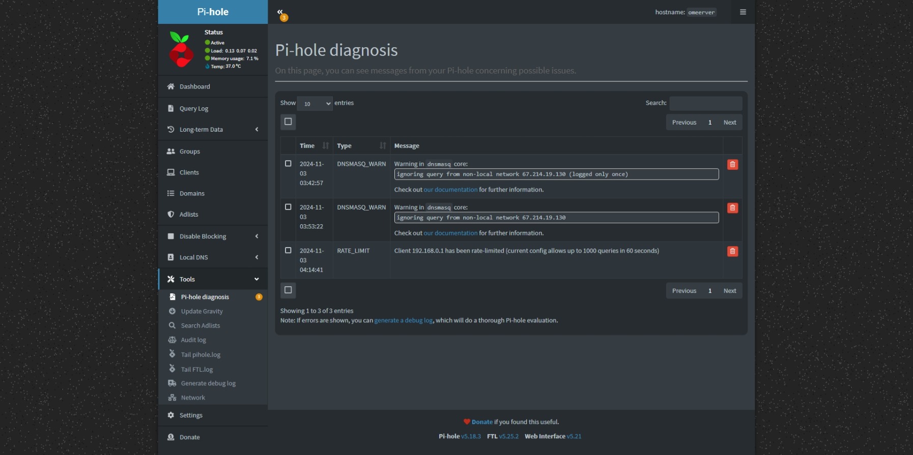

About the warning "ignoring query from non-local ...", keep an eye if any new warnings appear?
Do you have by any chance port forwarded/NATed DNS traffic on the router to the Pi-hole host IP to allow access from the Internet to your Pi-hole at home?
Bc thats not recommended as Pi-hole is not designed for that, security wise, and you could unwillingly participate in DNS DDoS reflection/amplification attacks against others if run an "open resolver"!
Also you wont get support here if run an open resolver.

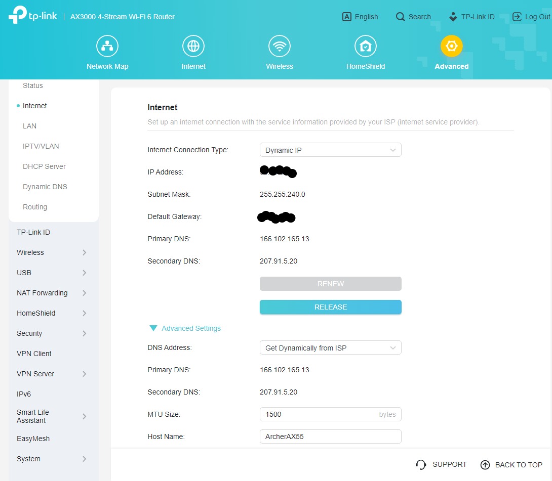

About the "RATE_LIMIT" warning, did you change any other settings on the TP-Link router?
Those settings in the TP-Link guide are the only settings you need to change for Pi-hole blocking and no others!

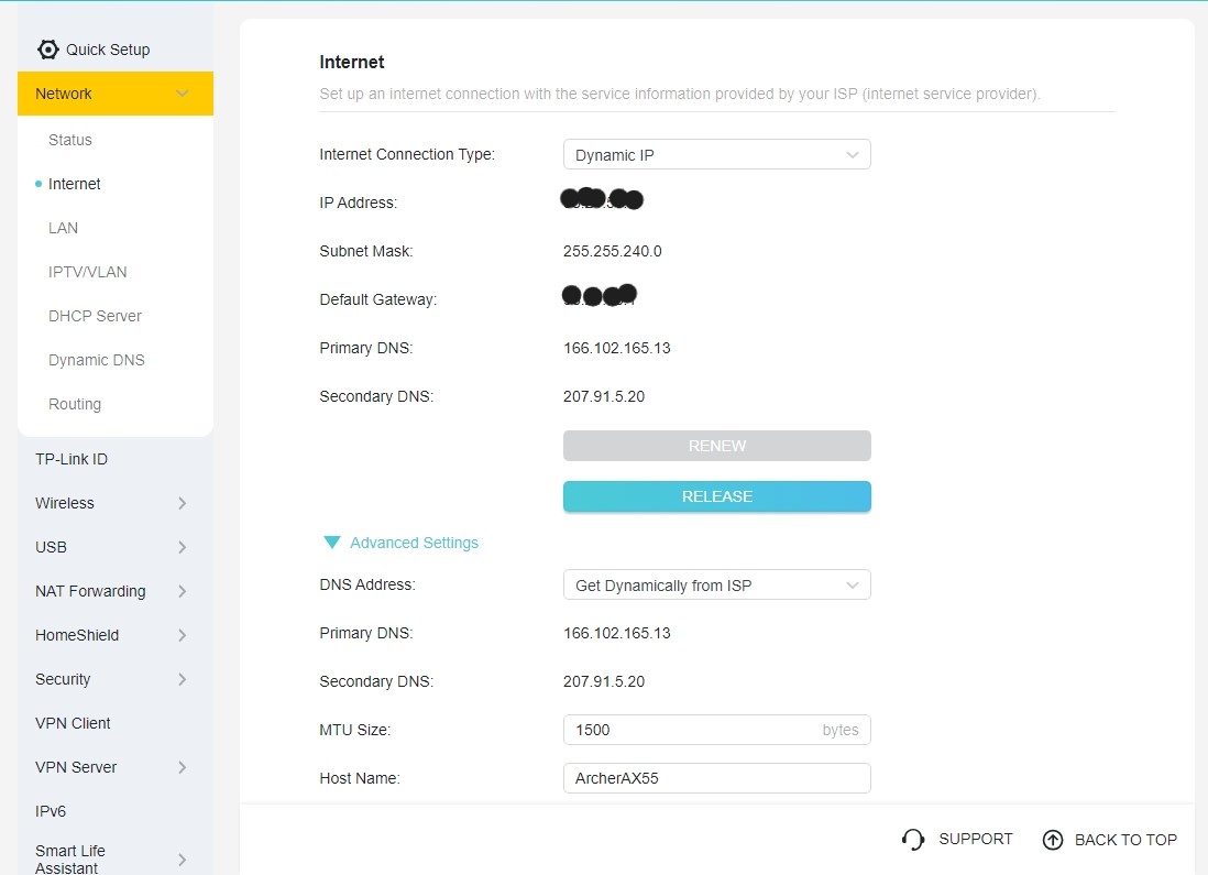

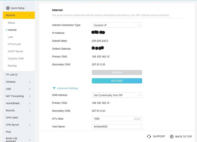

From that rate limiting warning, it seems as if you have the Pi-hole IP configured in the TP-Link WAN/Internet DNS settings?
Leave those WAN/Internet DNS settings on the router on OOTB defaults!
Something like "receive automatically".
If not, you'll likely close a partial DNS loop if also have Pi-hole "Conditional Forwarding" configured and enabled which will also trigger rate limiting.

Well being that i am not trying to be an accomplice in any ddos attacks I really do not know if my configuration is attributing to such so I will post Router screenshots and mark out my dynamic IP if that is even necessary.
Port forwarding has been left alone on the router admin page I do have MAC binded IP's and upon further investigation through trial and error if I set DNS to the IP of my pi which is 192.168.0.3 under DHCP settings, my advanced settings as seen in the first picture below, or in the DoT tab I am clearly doing something wrong. My TP Link will eventually get the orange light and I have to undo the changes and the IP renews again. Ideally would like to know if that issue was resolved if my adblock tester score would increase because it is currently at a 39/100.
"Internet settings" in the first screenshot looks good.
Those DNS servers appear to be from your ISP and not the Pi-hole IP which could potentially close a DNS loop:
$ dig +short -x 166.102.165.13
nsvip02.windstream.net.
$ dig +short -x 207.91.5.20
nsvip03.windstream.net.

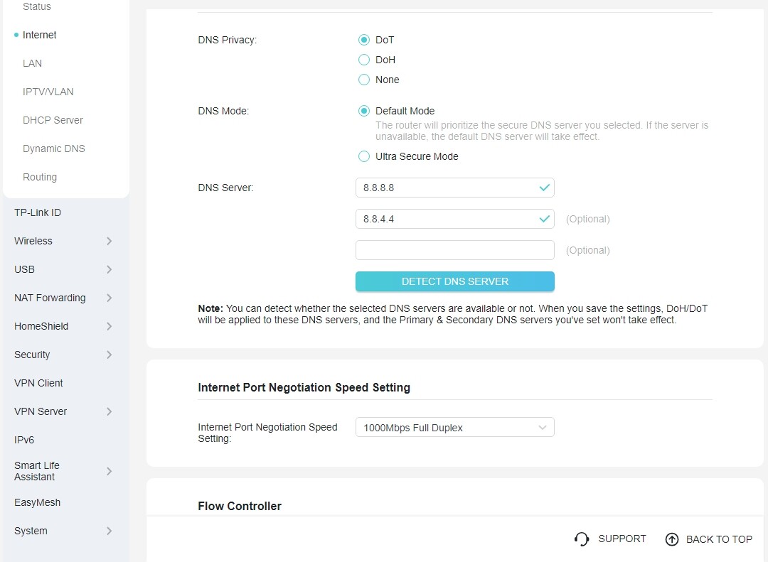

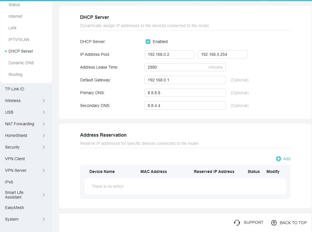

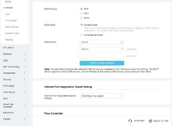

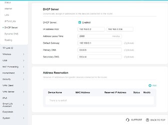

Why is the Pi-hole IP not configured for DNS in the "DHCP Server" settings but instead those of Google's (8.8.8.8 and 8.8.4.4)?

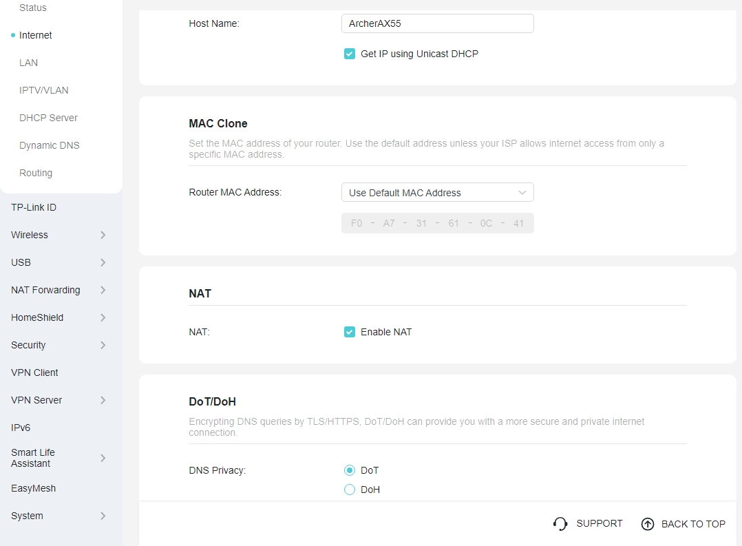

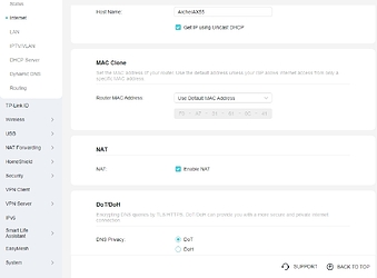

There is no mention of changing DoT or DoH settings in the official TP-Link guide.
So try revert those settings back to OOTB factory defaults.
Have more recent "ignoring query from non-local ..." warning messages appeared since last time?

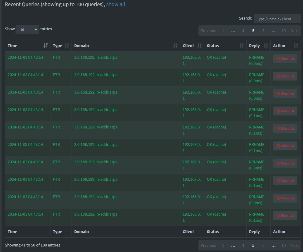

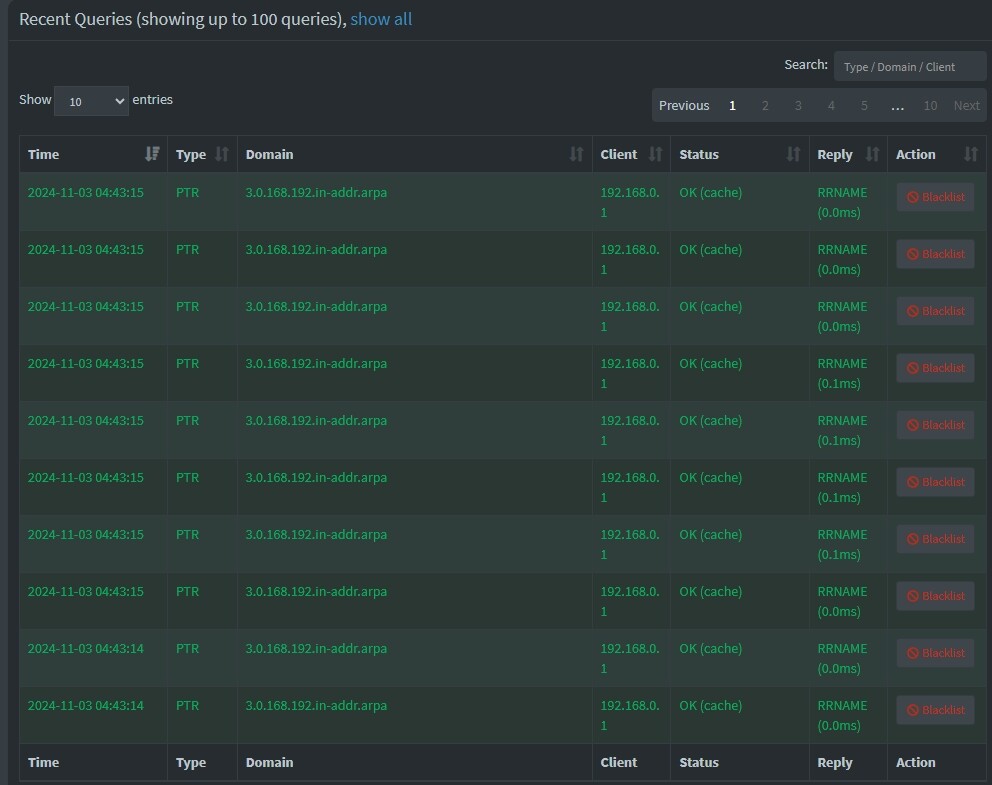

That flood of 3.0.168.192.in-addr.arpa PTR queries (reverse lookups) coming from the router IP @192.168.0.1 is evidence that something on the router is/was configured to make use of the Pi-hole IP for DNS resolution.
DHCP server DNS settings has nothing to do with that as these are advertised to the clients only.
Add that rate limiting was triggered, this is usually caused by a misconfiguration somewhere closing a DNS loop or partial DNS loop.
DNS queries bouncing back and forth between router and the Pi-hole host bc none of them can answer so they forwards the query to the other until rate limiting kicks in or resources are depleted (# concurrent connections, RAM, storage etc).
Are you still currently experiencing those floods?
No no more flood of the reverse DNS and every time I configure the DNS of my Pi's IP the devices do not work or the internet search i try as a test run will never load and time out
SO here ^ I should change the Primary DNS to the 192.168.0.3?
What does below return when run on your PC (not on the Ubuntu machine)?
nslookup pi-hole.net 192.168.0.3
Nooooo!
As said before:
Its the DHCP server DNS settings that needs changing from 8.8.8.8 and 8.8.4.4 into the Pi-hole IP 192.168.0.3.
For both DNS fields (primary & secondary) if the router allows.
Below settings:
In a nutshell, you only have to make it so that your router advertises the Pi-hole IP for DNS to the clients via its own DHCP service.

No other settings needs changing on the router except for creating a static DHCP reservation based on MAC if the Pi-hole host isn't configured with a true static IP (not one acquired via DHCP but one set manualy on the host itself).
My bad i must’ve misunderstood here, so that needs to be back to its original settings. i’m getting the notion to factory reset the router itself so i don’t miss anything.

Also found a hidden camera in my house that i was unaware of that’s what one of the ip’s i had earlier and another was just my smart tv in the living room i thought i had unplugged but someone clearly didn’t like it unplugged and took that upon themselves to plug it back in at some point
