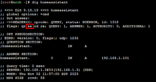

Hrm, it gets weirder. dig and nslookup are responding with a valid result yet anything else (ping, curl, web browsing) it won't resolve suddenly? What a bizarre problem!

I'm not completely sure but I think the Authoritative Answer flag being set in the first dig response is indicating that the Home Assistant itself is involved in the DNS resolution here, and is therefore responsible for the inconsistent behaviour you are seeing.
What do you see when running dig on other hosts in your /etc/hosts? Do they resolve as expected and are they missing that flag?

I doubt that, as Pi-hole would be expected to set that for domains it's authoritative for, which would include the domains from the local hosts file.
You're right – I tested it before posting and was only getting aa on the custom pihole domain I use and not the other custom domains. However I didn't spot that the others were in fact not resolving anyway because I wasn't using the domain suffix. When I do, of course it resolves and shows as authoritative.
However if Home Assistant is usurping the DNS in some way (maybe some helper application running locally, I don't know how it works), and it likely has the same hostname set, that might explain its own hostname resolving but not the hosts entries, since they are not seen. The txt dig should reveal if something like that is going on.
