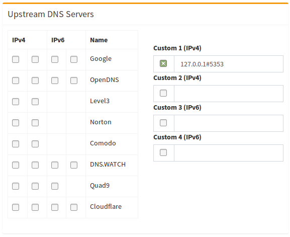

If I'm understanding the request, you can already do this:

Hello,
for me, it does not accept the #. I just cannot type it.
It just accepts numbers.
Even when editing setupvars manually (127.0.0.1#5354) in the web-interface this turns into 127.0.0.153.
I am using pihole f38c65d78a67 (docker:latest)
Greetings,
Hendrik
Ok, got it. pi-hole was to-late, as I was using diginc/pi-hole instead of pihole/pihole. The first was not being updated anymore.
