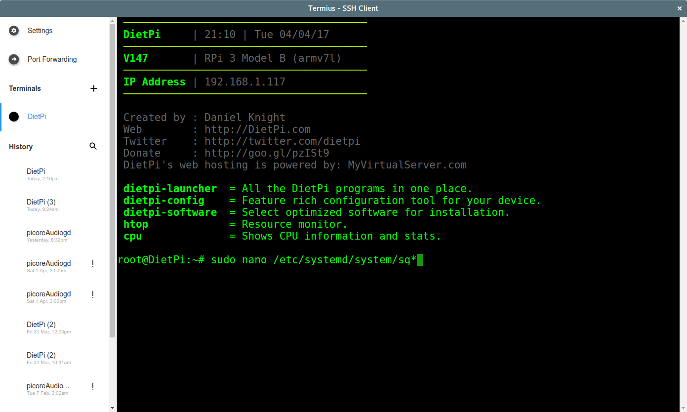

With Pi-Hole 3.x, I could SSH via the root account and when I logged in, it displayed this nice little welcome screen with commands I could type. Like how to update, how to check CPU temp.... something about HTOP I think.
Now, when I log in as 'pi', I get none of that. Thankfully, I remember the 'pihole -up' but what were the other commands? Why aren't they displayed at login?
I think if I could SSH in again as root, I might see that login screen I'm referring too.
I searched on Google for about 30 minutes to try and find a freaking picture of that login screen but came up empty. I guess I can live without logging in as root but I'd like to know how to get that screen back with all the commands I can type after SSH'ing into Pi-Hole as user 'pi'.
