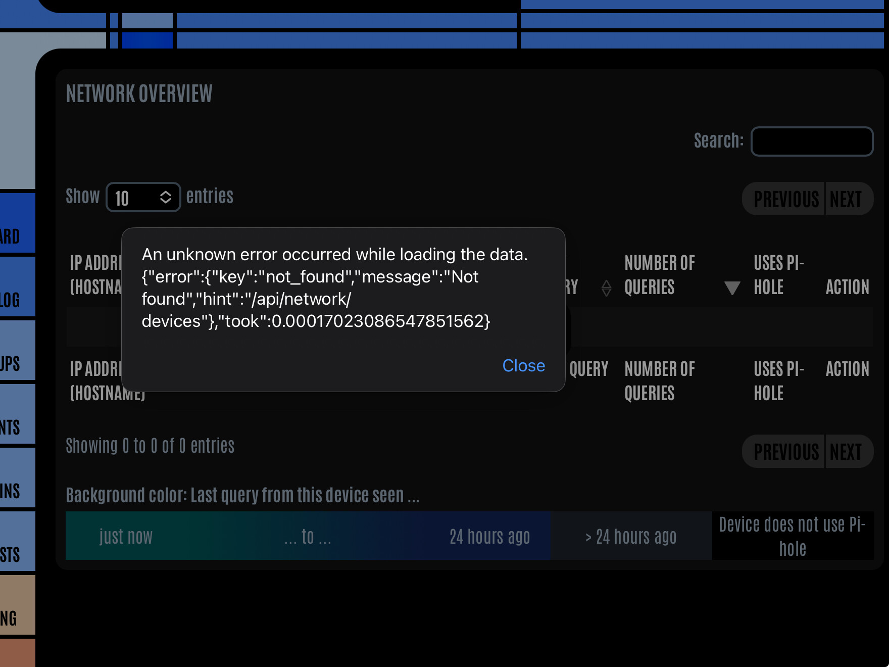

When I click on the 3 buttons on the dashboard expecting to see queries or blocked queries.
I get no queries listed and when I click on the XXActive Clients one It throws an error.
An unknown error occurred while loading the data.
{"error":{"key":"not_found","message":"Not found","hint":"/api/network/devices"},"took":0.00019192695617675781}

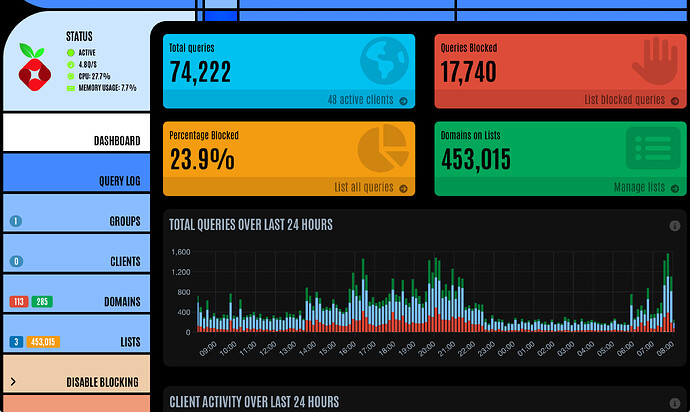

Thanks for the response. I have flipped those debug flags back off.
I was looking for the option to generate/upload the debug from the gui but that seems to be gone in this version.
I’ve also disabled ipv6 as suggested. Pihole is receiving and processing requests but it just doesn’t show anything in the interface when I click in the buttons on the dashboard.
