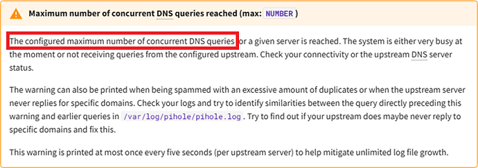

No option to configure the maximum number of concurrent DNS queries despite dnsmasq warning information
The Known dnsmasq warnings page on https://docs.pi-hole.net/ has the following information:
I searched all the settings, looking for the option for configuring the maximum number of concurrent DNS queries.
It was only after web search, that I learned that this configuration option is not in the settings, currently.
Please add an option for configuring the maximum number of concurrent DNS queries, or make it clear that it is not possible to configure the maximum number of concurrent DNS queries in the Pi-hole settings.

... in the Maximum number of concurrent DNS queries reached (max: NUMBER ). information on the dnsmasq warnings - Pi-hole documentation webpage.

My suggestion was, make it clear in the Maximum number of concurrent DNS queries reached (max: NUMBER ). information, on the dnsmasq warnings - Pi-hole documentation web page, that it is not possible to configure the maximum number of concurrent DNS queries in the Pi-hole settings.
