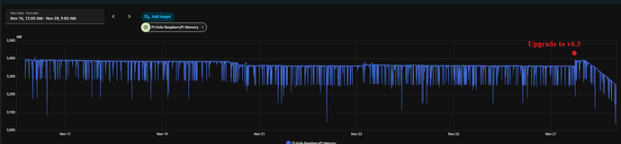

I run Pi-Hole on a RPi4. This RPi4 is used exclusively for Pi-Hole. After updating to v6.3, I noticed the memory being used up more and dropping steadily. Here’s the memory profile:

A leak would cause memory utilization to increase, not decrease.
8% is not high to me, you bought all the ram, might as well use it, you don't get any benefits from trying to save RAM.
Hey Dan!
Thanks, sorry it's not clear on the graphic but the plot is showing how much memory is left.
It's still a bit unusual for this system I'll post an update later. I agree with you, that it you should use most of the memory as long as it stops at some point.

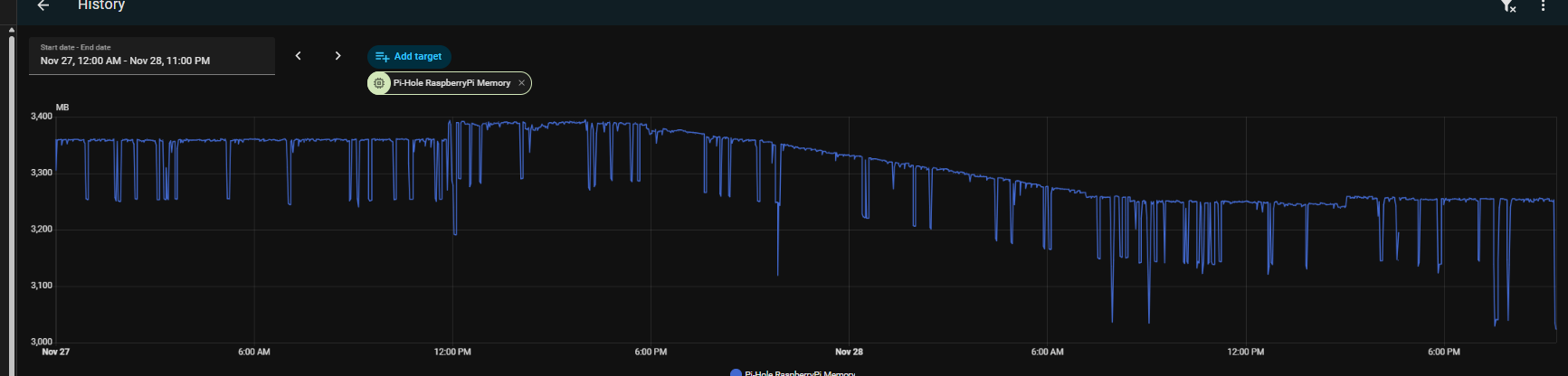

things seem to have stabilized
memory usage for PiHole went up slighlty to 8.2%
Ok false alarm. Not sure what caused it, but should be good now.
Cheers
Still not clear if that graph is showing "free" or "available" memory?

There is a huge difference.
You want it to show "available" and not "free" (see link ^).
It's available memory
