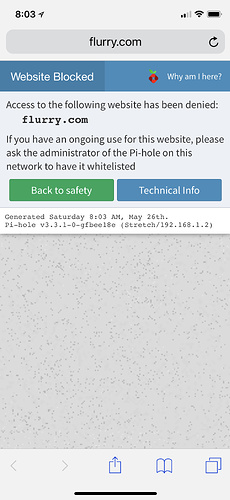

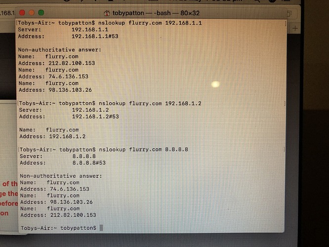

Pi-Hole should be acting as my DHCP service, and my DNS service and allowing my web pages to load without ads.
DNS and DHCP are both active, and resolutions are being forwarded from Pi-Hole as shown in the logs but nothing is loading, and I need to manually alter the DNS Server address on a device to 8.8.8.8 for internet to work.
As I cant upload the script, I’m just uploading the results.
I don’t mind about the personal info in the results. It’s not too personal in the grand scheme of things.
This process collects information from your Pi-hole, and optionally uploads it to a unique and random directory on tricorder.pi-hole.net.
The intent of this script is to allow users to self-diagnose their installations. This is accomplished by running tests against our software and providing the user with links to FAQ articles when a problem is detected. Since we are a small team and Pi-hole has been growing steadily, it is our hope that this will help us spend more time on development.
