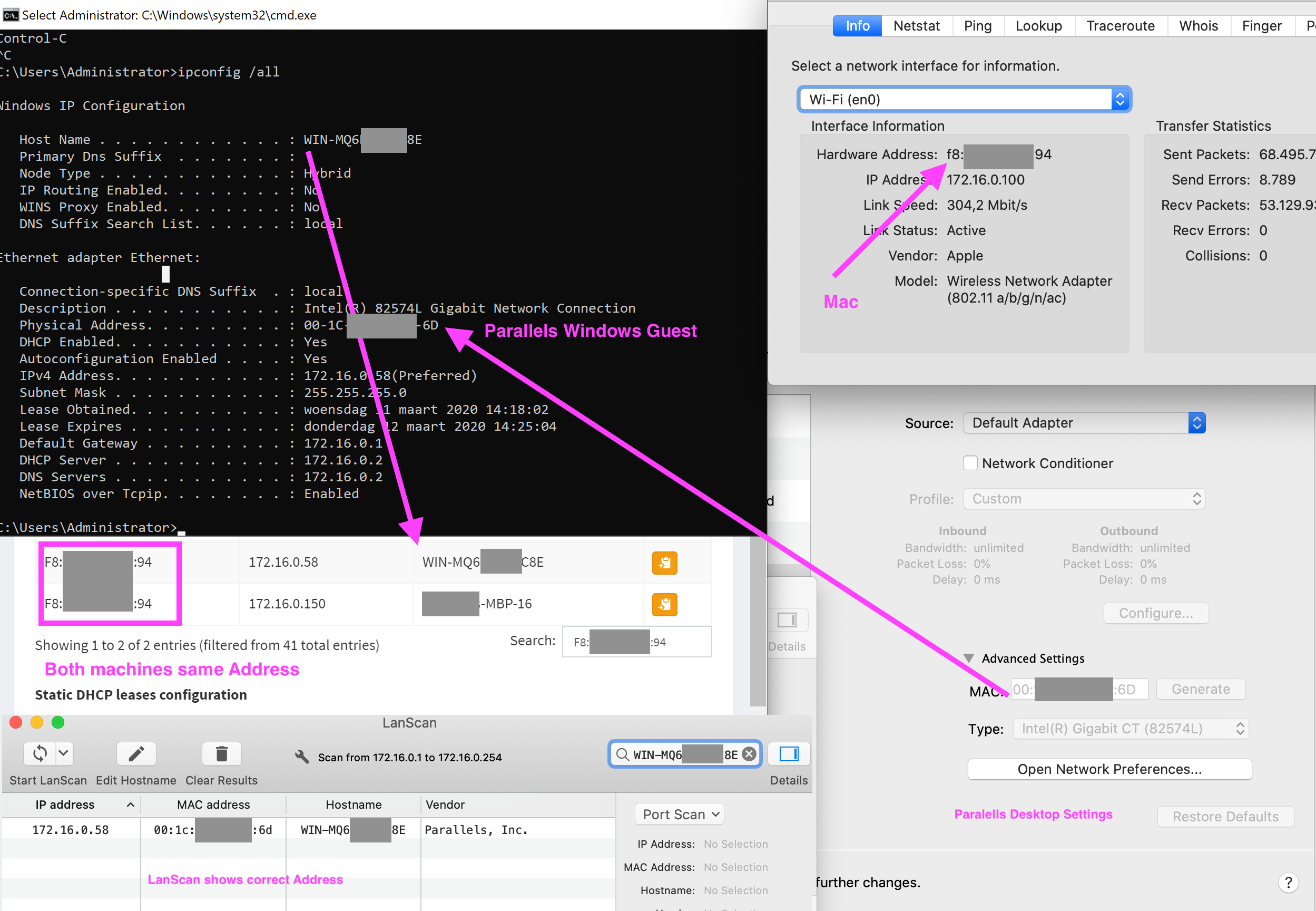

I think I found the issue.
I'm running Parallels Desktop on my Mac with Windows as the guest system. Pi-Hole actually registers both my Mac and the Windows guest with the same Mac address. Other apps like LanScan do see the correct Mac address.
So, when I make a reservation based on Mac address the DHCP can't give both systems the same IP, there it goes wrong I presume.
I made a screenshot to show the issue.
