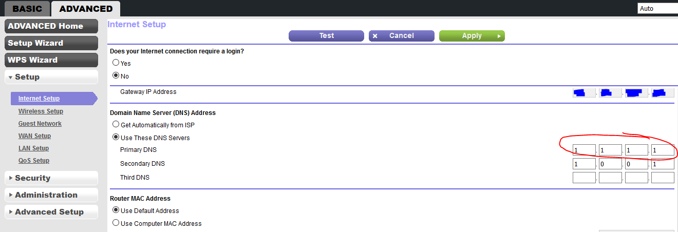

How did you configure your router to make use of Pi-hole?
a) use Pi-hole as its upstream DNS server (commonly a WAN / Internet setting)
b) distribute Pi-hole as local DNS server to your DHCP clients (commonly a LAN setting)
c) both
I think I did the first one. Setting the 192.168.1.48 address of the RPi in place of 1.1.1.1 as shown here.
Yes, I agree that looks like an upstream setting.
You can introduce Pi-hole into your network in this indirect way.
However, Pi-hole would not be able to attribute DNS statistics to individiual client IP addresses this way, since it sees all DNS requests as originating from your router.
If your router supports it, you can have individual client statistics if you'd distribute Pi-hole via your router's DHCP server. This would also be the preferred way.
Can you check whether your router supports distributing local DNS servers via DHCP?
