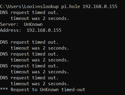

nslookup pi.hole 192.168.0.155
nslookup google.com 192.168.0.155
Both shows the same result from my window cmd.
Which is...?

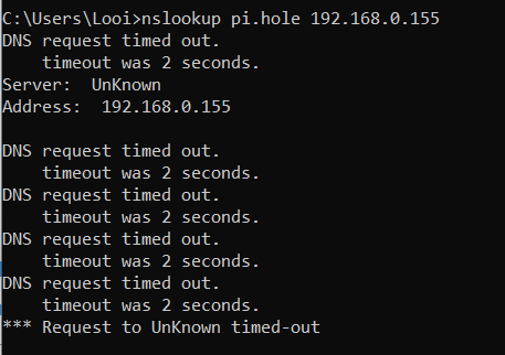

Sorry i did not know my image did not get upload, i tried again but to prevent it never get upload again i will paste the command result below:
C:\Users\Looi> nslookup google.com 192.168.0.155
DNS request timed out.
timeout was 2 seconds.
Server:  UnKnown
Address:  192.168.0.155
*** Request to UnKnown timed-out

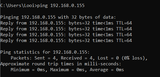

The timeout indicated that your Pi-hole device was not reachable or did not respond. Can you ping it?
ping 192.168.0.155
Pinging was no problem as i always SSH into it for administration stuff because my Nextcloud is hosted on this server.

Ok, lets recap:
You can ping your Pi-hole device on 192.168.0.155 but sending a DNS request to this address (nslookup pi-hole 192.168.0.155) timeouted.

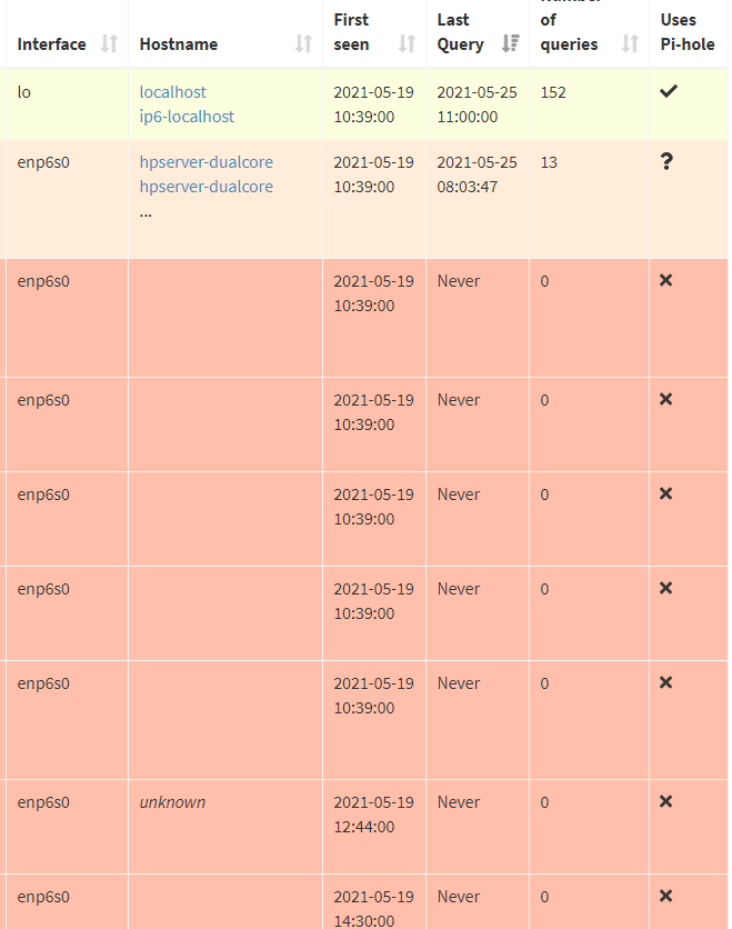

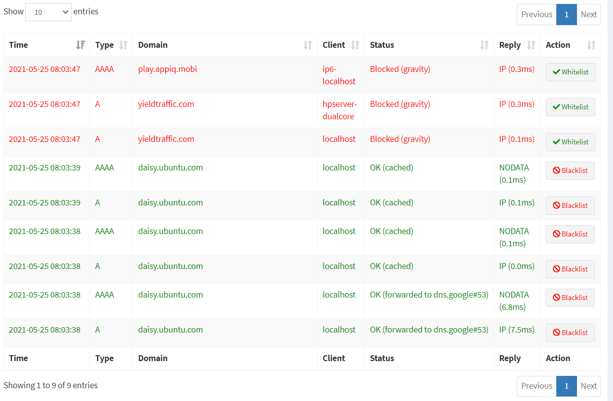

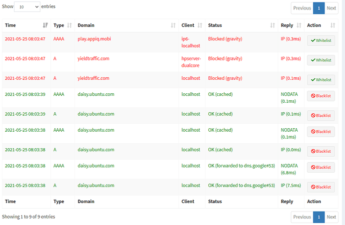

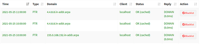

Im not quite sure what those query means. But i dont think it works. Because whenever i specifically specify my PC's lan network dns server to be the pihole server then i wouldn't have any internet connection, but if i let auto config then my internet connection comes back which i believe it invoke the secondary DNS, where i believe at this point it wouldn't go through Pihole so therefore no query will be listed?
I think it does. It shows queries from two different devices (localhost and hpserver). Some are answered (green) and some are blocked (red).
Pleaese try again
and look for the corresponding entry in the query log.

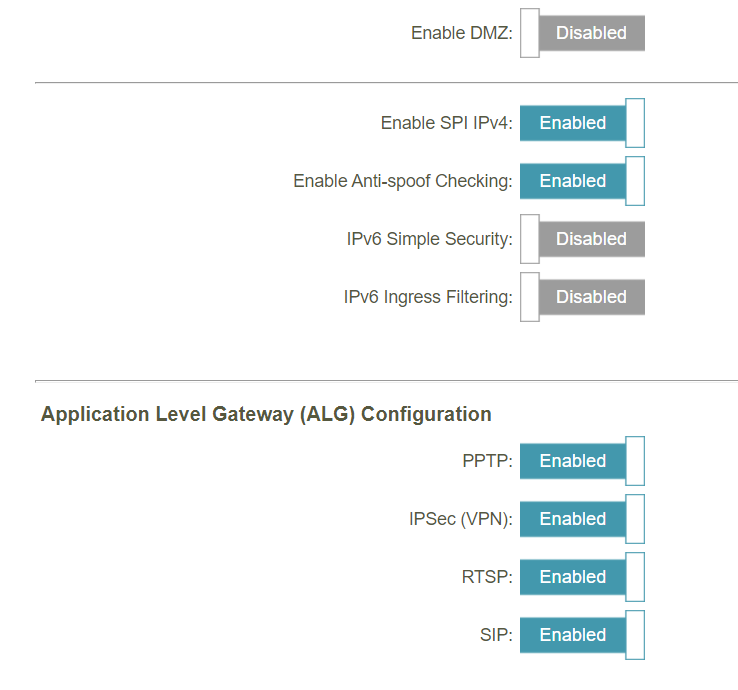

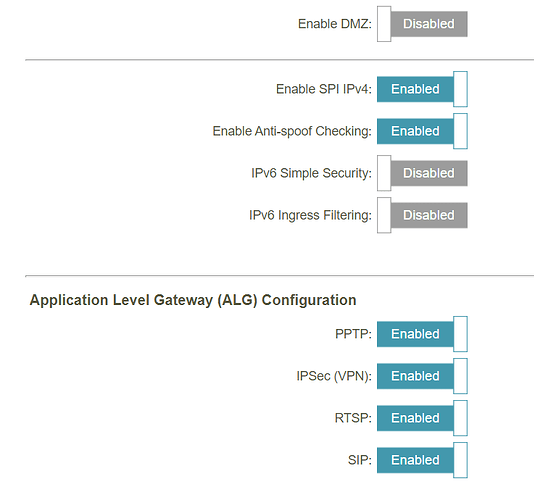

Do you use any kind of firewall or do you block DNS queries on the router level?

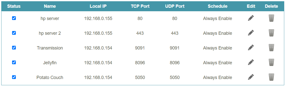

SnapShot
Above are some snap shots on my router setting, not sure if it's relevant but i do not know how to check whether i block DNS queries on the router level, is there any specific terms i should look in my router setting page?
No i do not use any kind of firewall.
I just did the nslookup.
hpserver you mentioned above was actually the Pihole device itself.

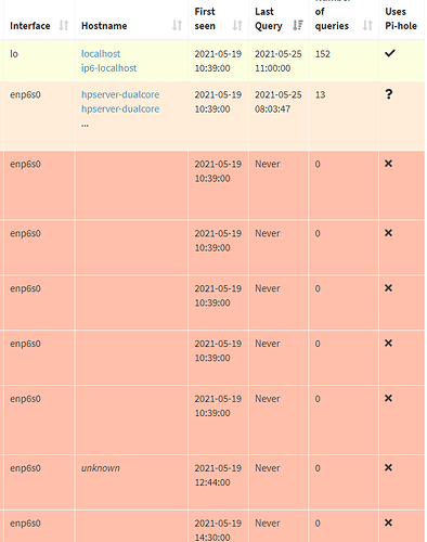

I still think the network did not route through the pihole, because i have 10 plus pc in my office and the query just look way too low. I then went to Pihole Web Interface -> Tools -> Network.
I only have 1 device are using pihole which is localhost 127.0.0.1::1 (152 queries) which i believe it was the router??
Another is hpserver 192.168.0.155 (13 queries) which is pihole server itself but pihole doesn't know whether or not this device uses pihole.
What router and model do you have?
Your nslookup results show that DNS requests for local (pi.hole) as well as public (google.com) domains time out, even if targeted directly at Pi-hole at 192.168.0.155.
This would indeed suggest a firewall interfering, preventing Pi-hole from receiving the DNS requests or discarding its answers.
Please repeat the nslookup commands and monitor if those requests do register in your Pi-hole's Query Log.
If they don't register, please verify that your Pi-hole host machine's firewall isn't blocking Pi-hole's required ports.
If those nslookups do register and/or all required ports are accessible on your Pi-hole host, then that would suggest your router is blocking DNS traffic.
If you cannot find any router settings related explicitly to blocking DNS/port 53 on your local 192.168.0.0/24 network, you'd have to consult your router's documentation and suppport channels.
For a start, you could try to find out whether that Anti-spoof Checking would prevent local handling of DNS requests.
Sharing your router's make and model as requested by yubiuser may help to attract users with relevant similar experiences.
