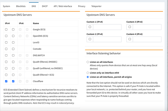

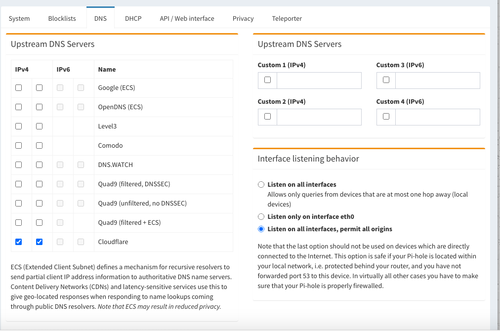

I've setup pihole to listen in on all interfaces -
So shouldn't I be able to access Name Resolution by using the public IP address as well?

Not according to the screen capture you posted. Pi-hole is using Cloudflare for upstream DNS.
I had first suspected an issue with my unbound configuration and hence flipped pihole to Cloudflare.
