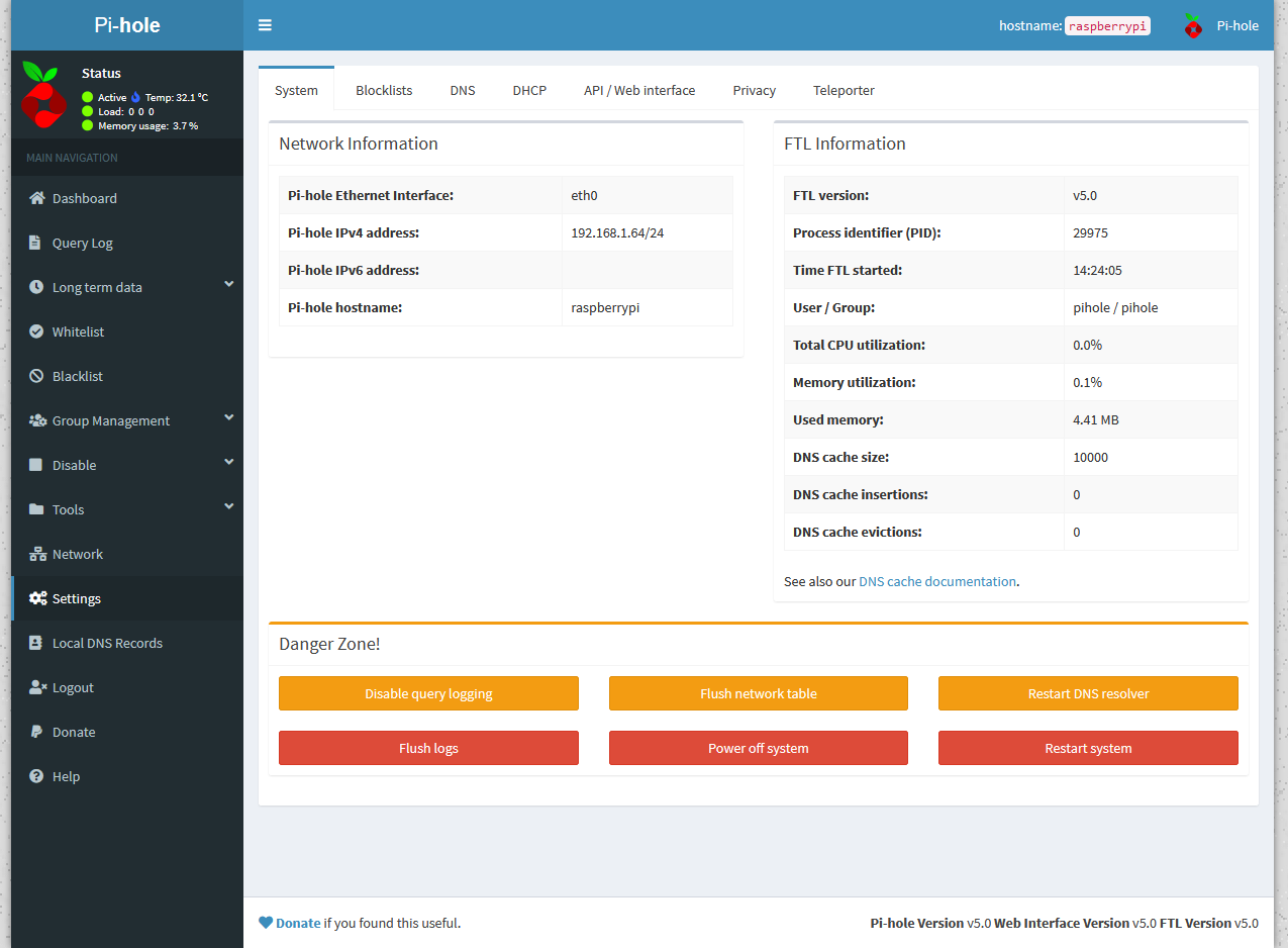

No blocklists - can't add new blocklists

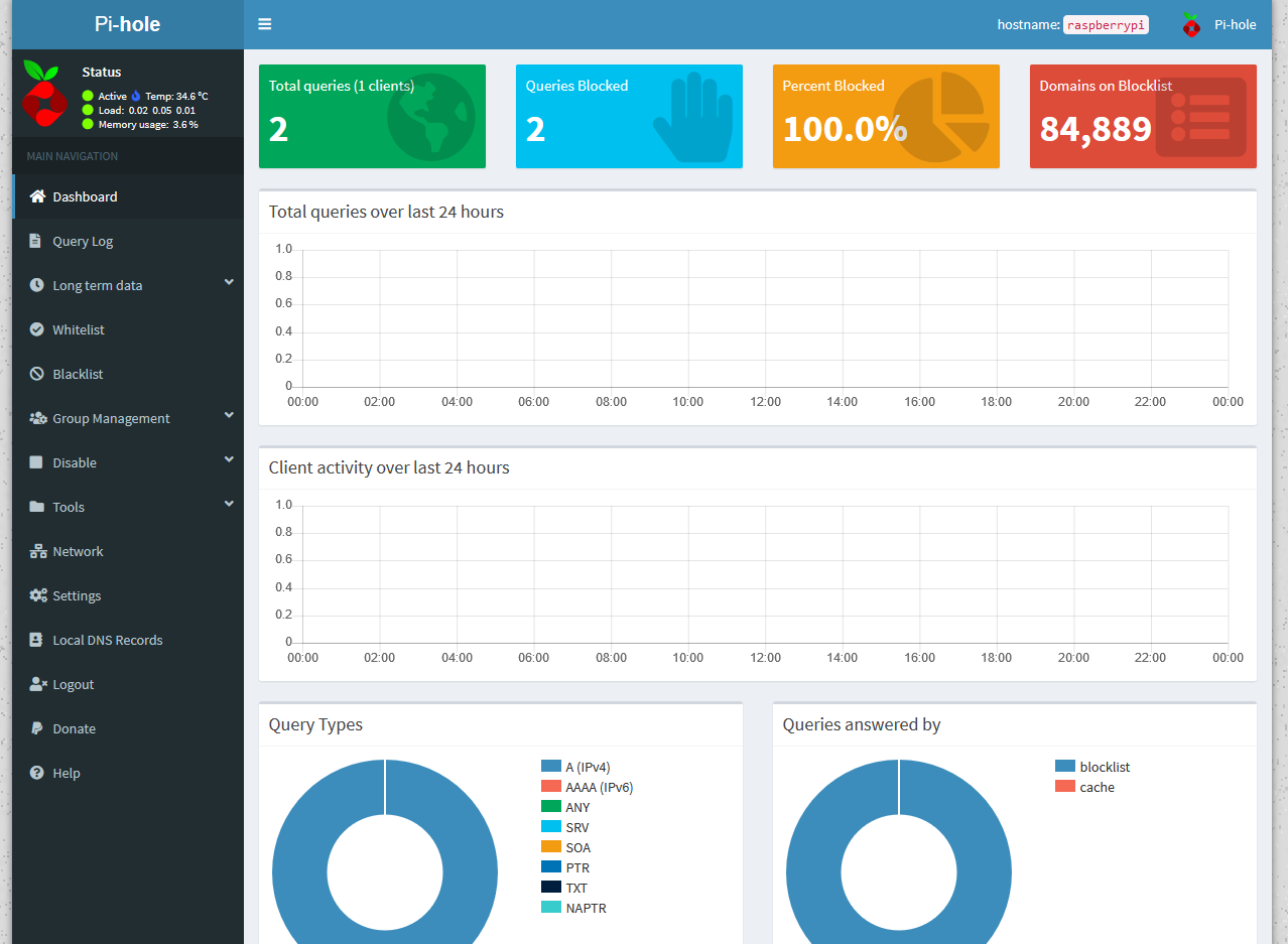

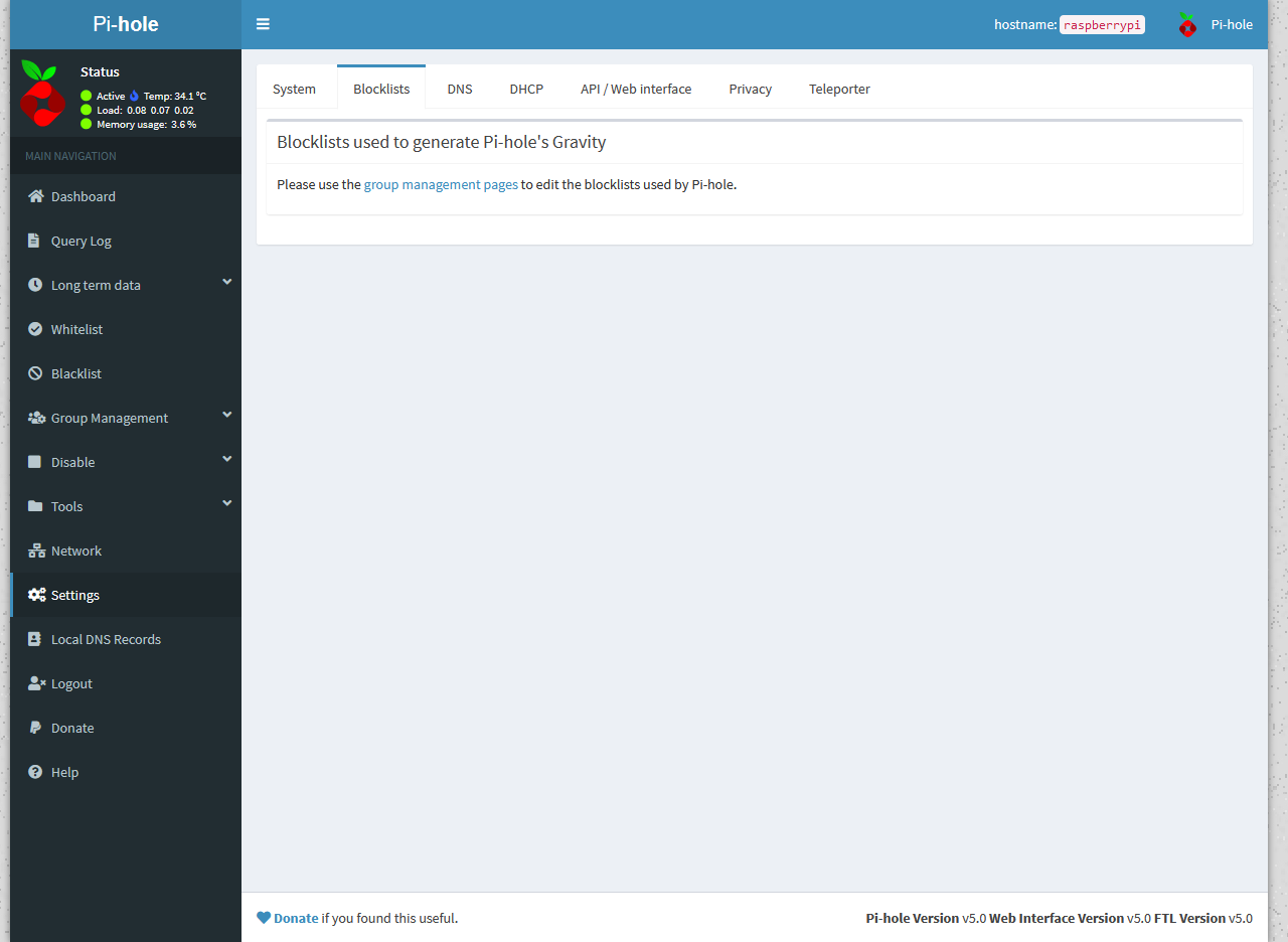

I should see in Settings / Blocklists something, with the checkboxes for enable/disable and so on.
I dont see anything there.

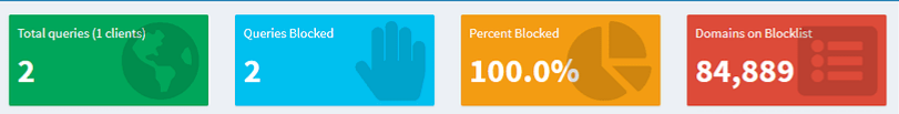

In the dashboard, I have 0 total queries, 0 queries blocked, but 84,899 domains on blocklist.

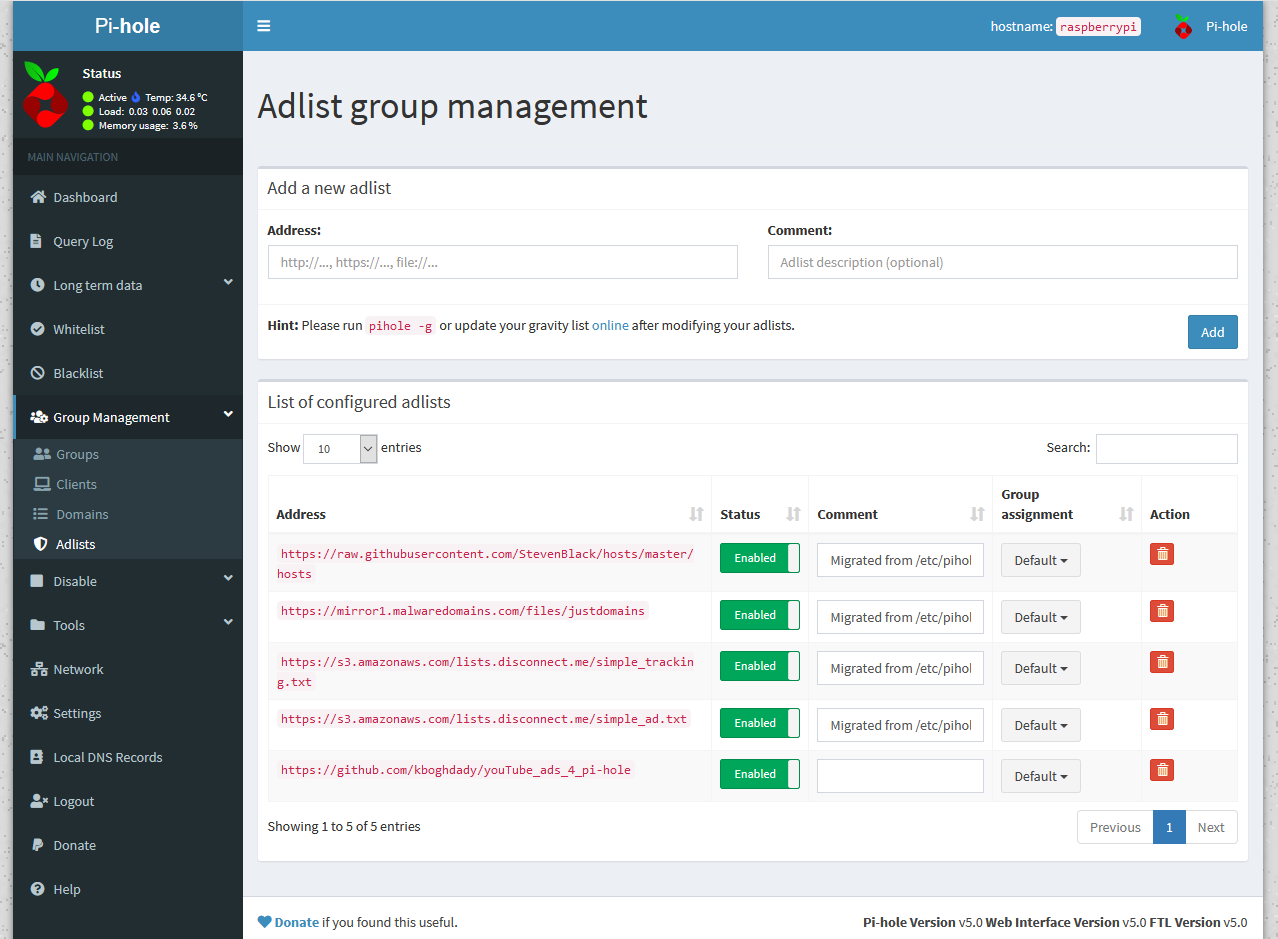

No, you should not. The function is moved to the group management page, as indicated on your first screen capture.

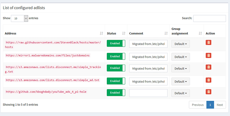

You can add blocklists on the group management page, but not if they are duplicates. It appears you have tried to add duplicates. This warning appears three times in your debug log:
2020-05-15 21:46:49: (mod_fastcgi.c.421) FastCGI-stderr: PHP Warning: SQLite3Stmt::execute(): Unable to execute statement: UNIQUE constraint failed: adlist.address in /var/www/html/admin/scripts/pi-hole/php/groups.php on line 687

On second look, these do not look normal - active IP is on the WLAN0 interface, but the static IP is assigned to the eth0 interface:
3: wlan0: <BROADCAST,MULTICAST,UP,LOWER_UP> mtu 1500 qdisc pfifo_fast state UP group default qlen 1000
    link/ether dc:a6:32:39:a2:88 brd ff:ff:ff:ff:ff:ff
    inet 192.168.1.64/24 brd 192.168.1.255 scope global dynamic noprefixroute wlan0
interface eth0
        static ip_address=192.168.1.64/24
Get this sorted out and then run a new debug log.

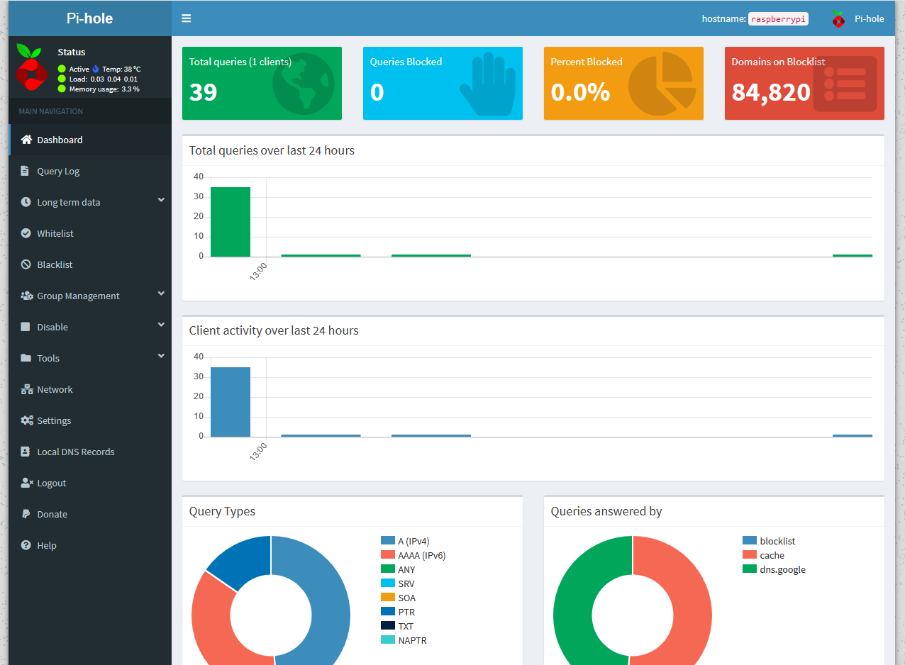

However, now it registers some queries, but theres any ads being blocked.

The 39 queries you see are from Pi-hole on the internal loopback address and you would not expect to see any of these requests blocked.
