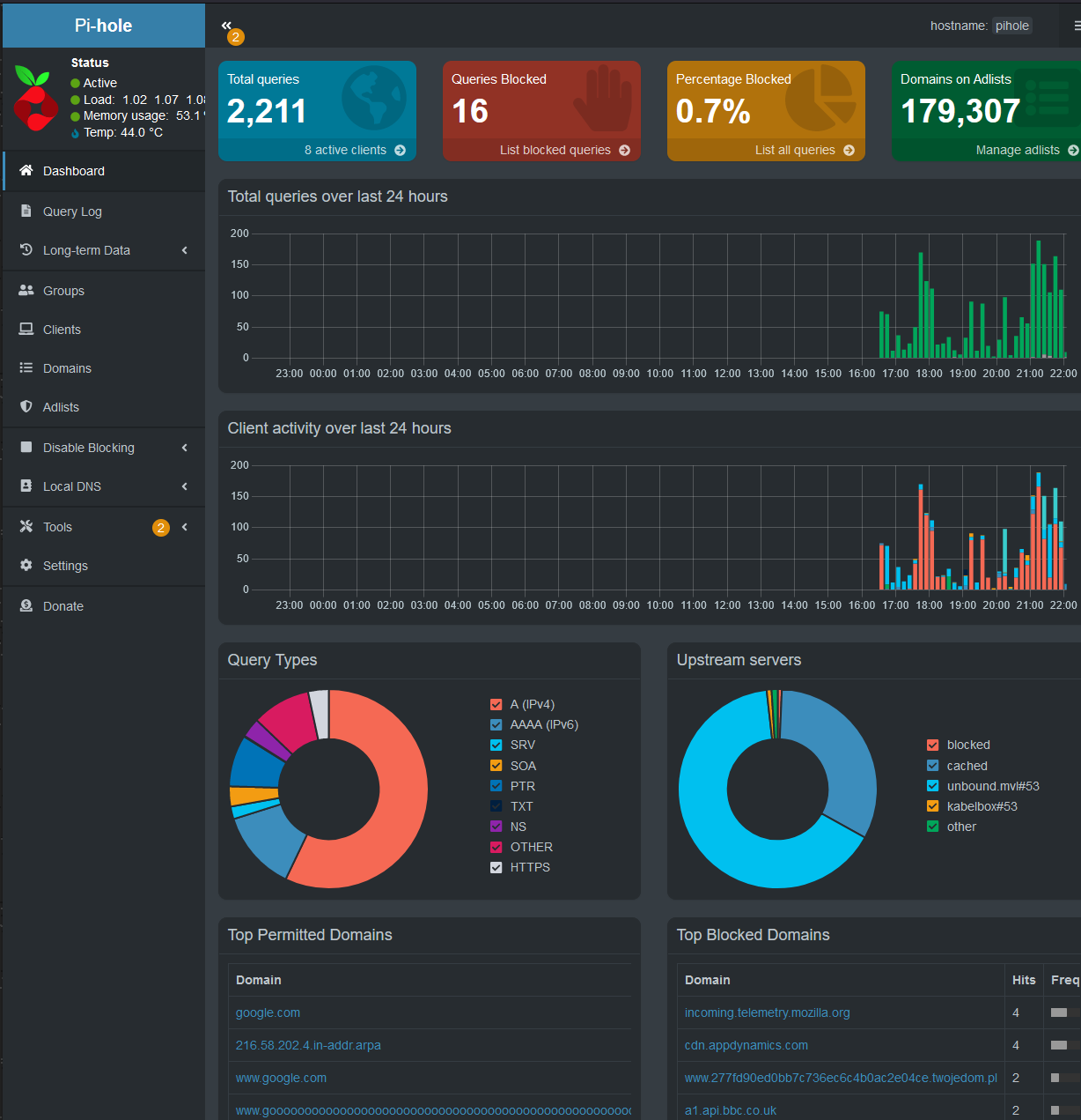

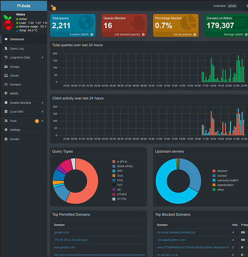

@Bucking_Horn I'm surprised by the FTL.log shows no connections as the dashboard actually shows (occasional) connectivity. See screenshot below.
I restarted the Vodafone Station 6 router to end DHCP leases by that router that existed prior the switch to Pi-hole. It seems to have worked fine for IPv4 but most of my devices seem to prefer IPv6 and therefore directly connect to the router bypassing Pi-hole. I hope this can be fixed. Apparently, IPv6 cannot be deactivated at the router.

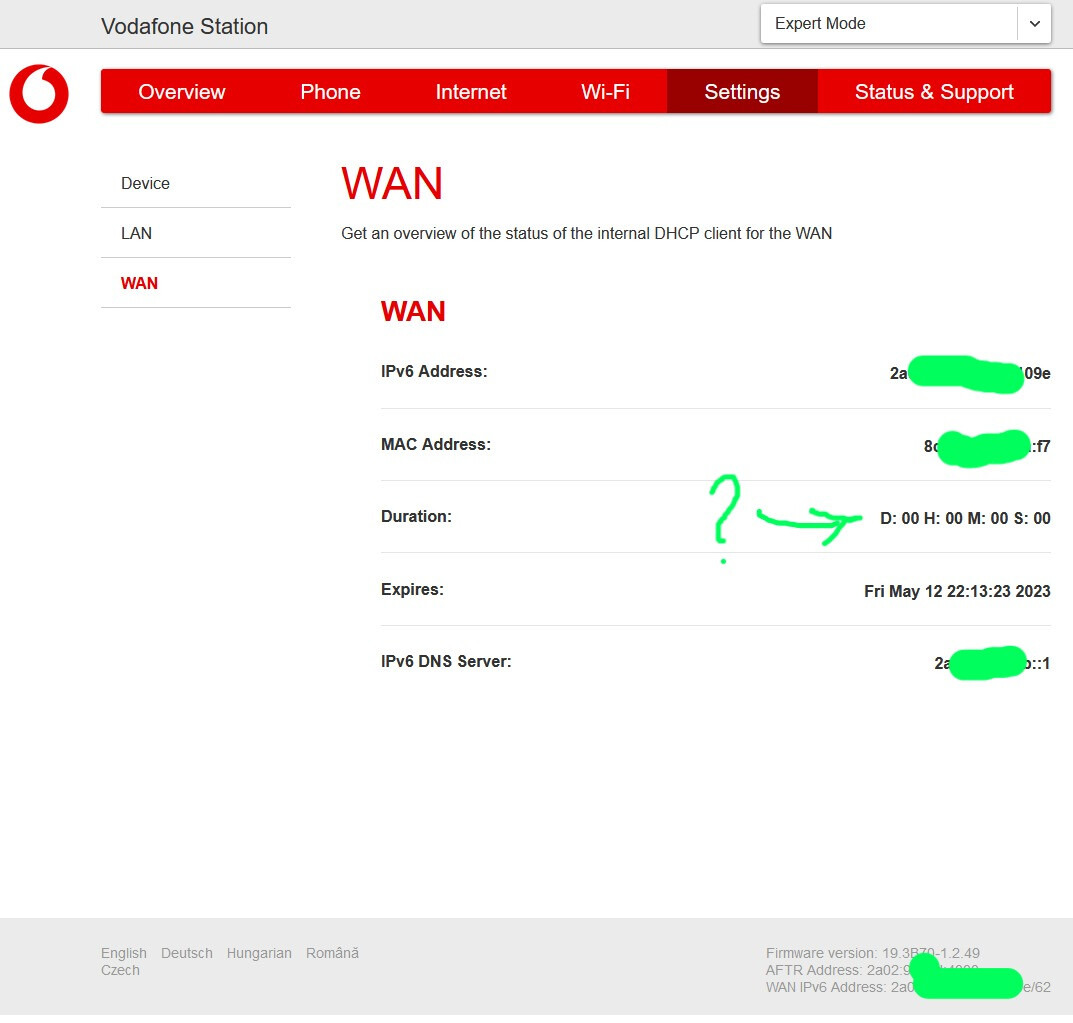

The screenshot below show the WAN interface. It is all based on IPv6.

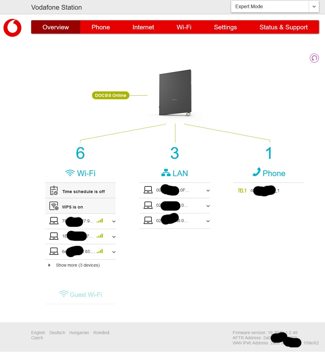

All my devices are connected to the router via IPv6. See screenshot below.
So, I hope there is something that can be done besides changing the router to fix the IPv6 connection bypassing Pi-hole. Also, given that Vodafone expressed their interest in pushing me into a higher tariff for allowing me to use a third-party router.
The log excerpt shows the result of loading Pi-hole's long-term database after a restart at 14:22:47 today. It is consistent with your screenshot, as clients only start to use Pi-hole for DNS at about 16:30.
I'm afraid not.
If your router is advertising its own IPv6 address (or those of your ISP) as DNS server, that would allow your clients to by-pass Pi-hole.
You'd have to find a way to configure your router to advertise your Pi-hole host machine's IPv6 as DNS server or to stop advertising its own.
If your router doesn't support configuring IPv6 DNS, you could consider disabling IPv6 altogether.
If your router doesn't support that either, your clients will always be able to bypass Pi-hole via IPv6.
