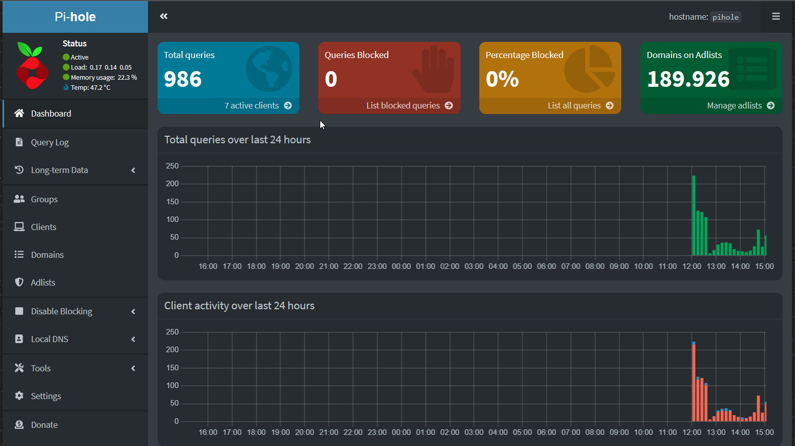

No adds blocked, a lot of queries though
expecting to block ads and numbers in dashboard to rise (queries blocked - percentage blocked)
queries: 736
queries blocked: 0
percentage blocked: 0
https://tricorder.pi-hole.net/9GCpPWJa/
pi-hole ip: 192.168.68.137 (dedicated)
pi-hole is not the DHCP server
only my pc connects to the pi-hole with ip:
ip4: 192.168.68.112
ip4-DNS: 192.168.68.137 (not encrypted)
DNS is manually altered
ip6 is off
doubleclick.net is black listed, just to see if that works
queries are now 832 but still 0%
thanks in advance for helping me out.

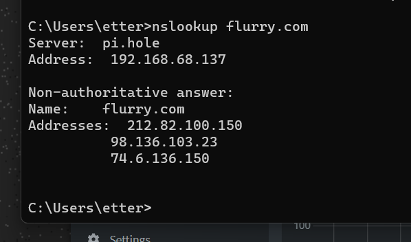

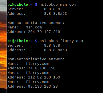

if it helps, 2 nslookup:
my dashboard:
based on your nslookup command, your machine is NOT using pihole (192.168.68.37) as DNS. If you are using Windows try the command ipconfig /all and it will show you your current DNS server. Hopefully a forum developer will give you more details explanation as to why when they look at your debug token.

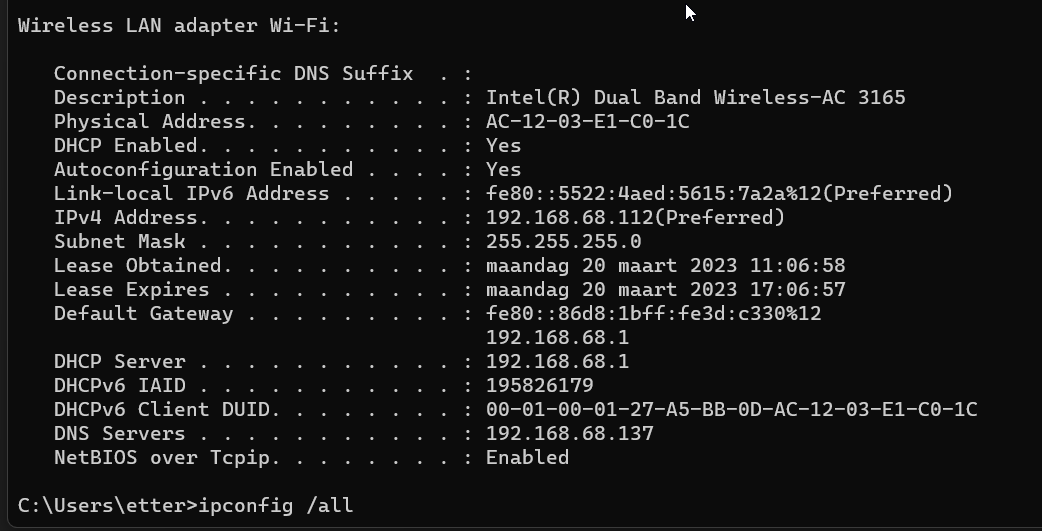

hi smurf and thx for your quick answer.
my ipconfig /all shows the dns is ip-hole....i guess
i see what you think, the 8.8.8.8 in the dnslookup. dunno where that comes from... i investigate further

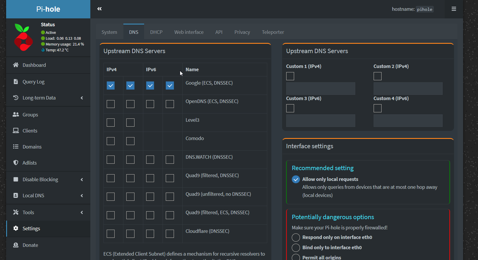

does the 8.8.8.8 come from here?:
You mentioned IPv6 is off, but your GW is pointing to both IPv4 and IPv6. I would also uncheck IPv6 on the pihole GUI if you're not using IPv6

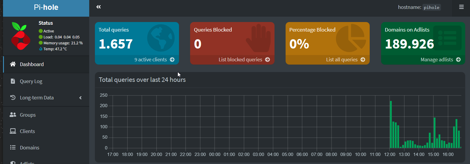

Thank you smurf. I changed that... see the results:
now lets hope my numbers go up in the dashboard......
I will post the result in an hour or so
good job...:smile: now add unbound and wireguard and you're all set to go
hmmm, still everything is replied bij dns.google#53. nothing blocked.
there must be something i am missing, what could be wrong???

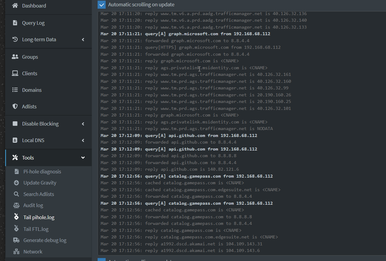

Here are a couple of things I would check
  1. Your router DHCP settings and make sure pihole is the ONLY DNS server
  2. Your adlists
  3. Go to Tools / Tail pihole.log and see if anything is being blocked

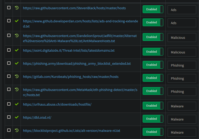

I noticed your dashboard domain on adlists is only 189.926. On mine I have 1,746,106. Below is my domain adlists

I had the router DHCP correctly installed, but my wife couldn't work from home anymore. So i changed it back to original settings. BUT my laptop is now the only one i connect (actively) to the pi by manually changed the IP settings (IP still by DHCP but DNS manually).
  • ipconfig / renew
  • ipconfig /all shows DNS is pihole (192.168.68.137)
  • adlist, i didn't change anything there, if you have 1,7M and mine is only 189K, then that is a good place to start looking.
  • Tail pihole.log ,
WE ARE GETTING SOMEWHERE !!!

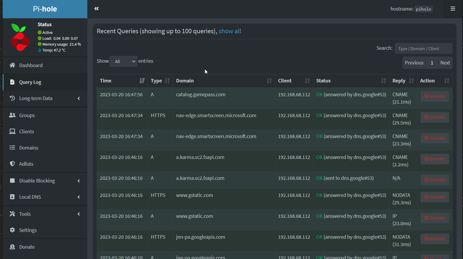

Check your groups. If you've defined groups, but haven't made your devices members of a group, it potentially won't block anything.
If you haven't manually set up any groups, ignore this. :slight_smile:
I think you're on the right track.
Your above nslookup result has shown the device it was run from was using Google's DNS servers (8.8.8.8).
How did you address that?
EDIT:
Your debug log shows your router to distribute two public DNS servers:
   * Received 300 bytes from eth0:192.168.68.1
     Offered IP address: 192.168.68.109
     DHCP options:
      Message type: DHCPOFFER (2)
      router: 192.168.68.1
      dns-server: 8.8.8.8
      dns-server: 84.116.46.22
      --- end of options ---
Seems you've addressed that already :wink:
I did made groups, like my name and IoT group but didnt place any devices in there yet. i wasn't ready with renaming all the devices (pi isnt my DHCP so names were unknown).
I removed all the groups and placed everything in the default group. but this was yesterday. today it still didnt work.
i think the 8.8.8.8 came from my DHCP server which had a 2nd DNS server .....8.8.8.8 were PI was the first.
I think it was still in the IP cache after i changed it to only one DNS (PI) when i runned dnslookup.
After that i run ipconfig /renew and it showed the correct DNS.

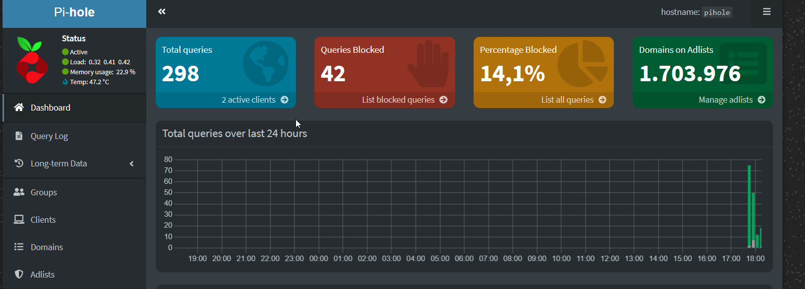

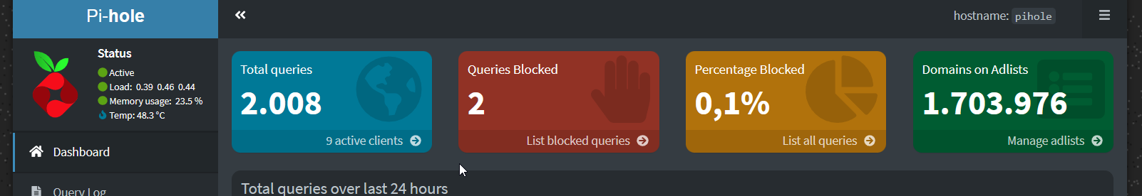

At this time my numbers are like this:
