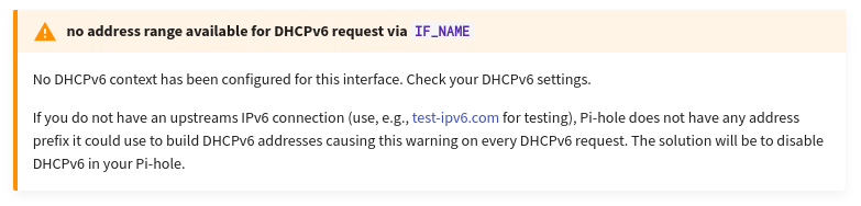

I get the following warnings at the Pihole web interface:
no address range available for DHCPv6 request via eth0

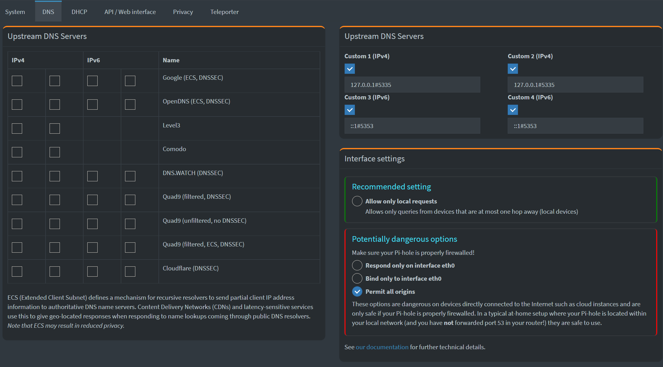

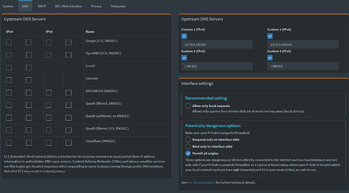

Added two new entries from UPSTREAM DNS (IPv6):

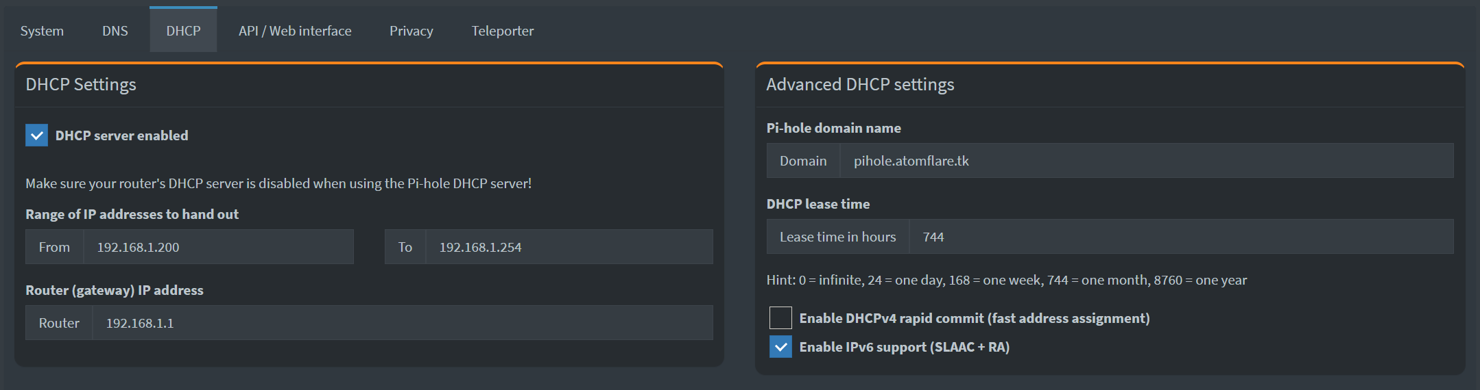

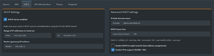

Added blocklists and enabled DHCP from the web UI:
I've set up UFW firewall rules, allowing 547 and 67 both only over UDP and from 0.0.0.0 (I actually had my firewall disabled for sometime and I've still gotten the mentioned warning)
I disabled DHCP (for both IPv4 and IPv6) from my router gateway. And by the way, what domain does it refer to at the Pihole Domain Name section? My public one, or is this just for local use only?
And what is DHCPv4 rapid commit for?

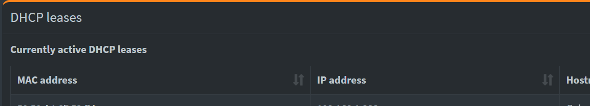

Will I see the IPv6 assigned by the Piholes's DHCv6 at the IP Leases section?

I had a look at the 02-pihole-dhcp.conf file in case it may help, but the IPv6 range is going from 100-1ff wich seems legit. I don't know what is the issue, and why I am getting the message No address range available for DHCPv6 request via eth0
#  DHCP SERVER CONFIG FILE AUTOMATICALLY POPULATED BY PI-HOLE WEB INTERFACE.  #
#            ANY CHANGES MADE TO THIS FILE WILL BE LOST ON CHANGE             #
dhcp-authoritative
dhcp-range=192.168.1.200,192.168.1.254,744h
dhcp-option=option:router,192.168.1.1
dhcp-leasefile=/etc/pihole/dhcp.leases
#quiet-dhcp
domain=lan
#quiet-dhcp6
#enable-ra
dhcp-option=option6:dns-server,[::]
dhcp-range=::100,::1ff,constructor:eth0,ra-names,slaac,64,3600
ra-param=*,0,0

Rapid commit is standardized by RFC 4039. The introduction explains it well:
1. Introduction
In some environments, such as those in which high mobility occurs and the network attachment point changes frequently, it is beneficial to rapidly configure clients. And, in these environments it is possible to more quickly configure clients because the protections offered by the normal (and longer) 4-message exchange may not be needed. The 4-message exchange allows for redundancy (multiple DHCP servers) without wasting addresses, as addresses are only provisionally assigned to a client until the client chooses and requests one of the provisionally assigned addresses. The 2-message exchange may therefore be used when only one server is present or when addresses are plentiful and having multiple servers commit addresses for a client is not a problem.
You will see this in clients registering faster in your local network. It is generally a good thing, however, only if the constraints (highlighted above in italics by me) are satisfied. This is not always the case as, sometimes, users have router and Pi-hole distribute DHCP - which should obviously be avoided as it can cause a lot of issues. The extra protection without rapid commit can often safe your network from collisions in this case, though.

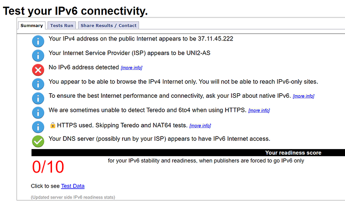

But as you've said I was missing the upstream connectivity without my knowledge, and it seems to be the issue, coming from my ISP.
To get out of doubt I've restored DHCP (v4 and v6) to router, stopped my pihole container, and accessed IPv6 test sites:
I just assumed I have IPv6 because I was seeing IPv6 addresses in my devices, and in my router.
Thank you for your great assistance.
