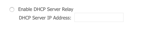

I found this on my router, but it doesn't let me turn it on.
I'll try to run it with --net=host, thank you for your answers, I've been quite stuck for a few days with this :slight_smile:
