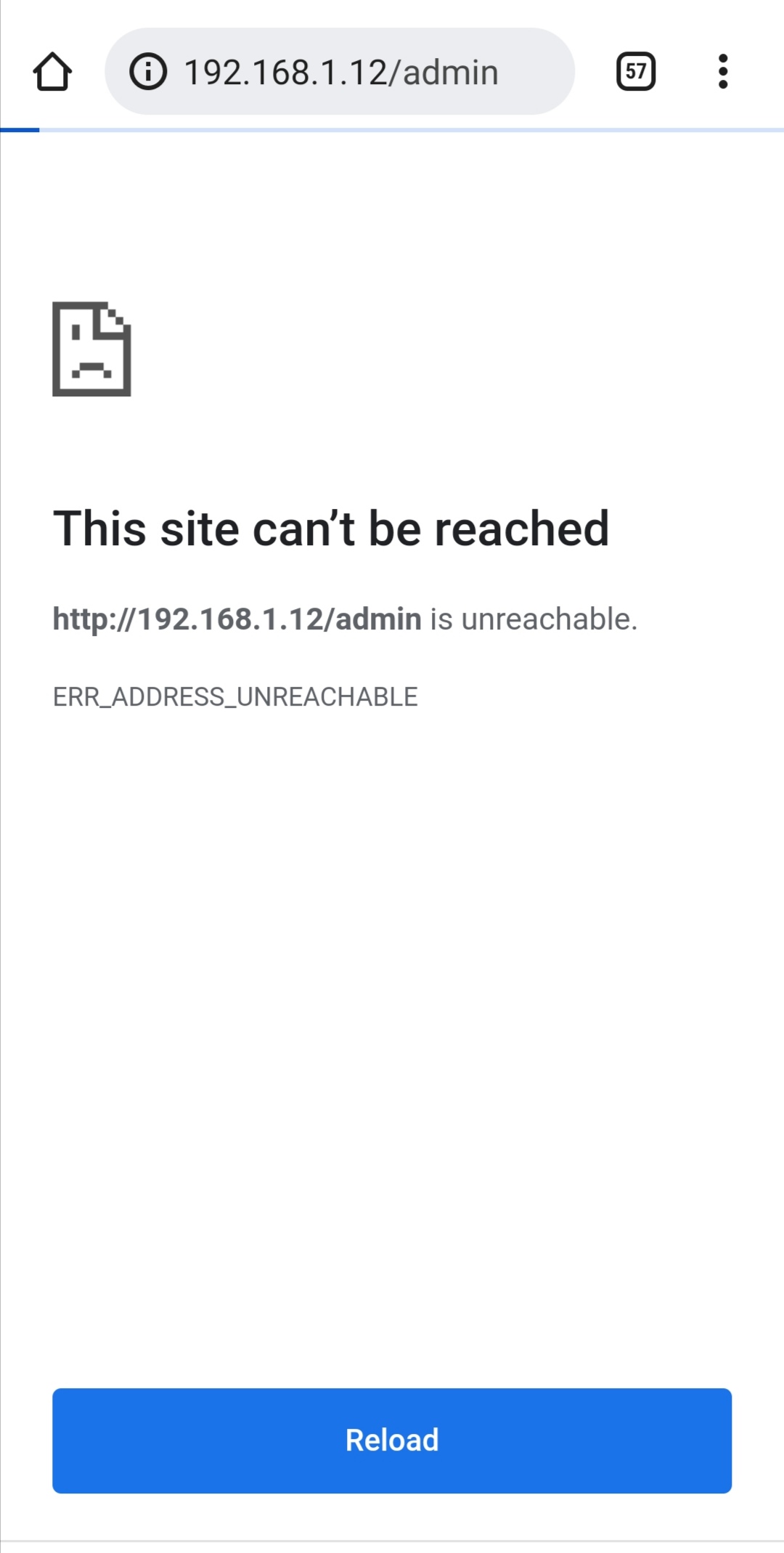

What is the exact URL you are using to access the web admin GUI? Please post that along with a screen capture of what you see on your browser when you attempt to load the web admin GUI.
In this forum, you can post a screen capture directly into a reply, from your clipboard. Or you can upload an image file if that is how you save screen captures.
I use 192.168.1.12/admin, I can only access the admin panel from the Raspberry pi,My laptop gives me an error and my phone as well
Given that the Pi can access the admin page, there may be a problem with those clients connecting to Pi-hole.
Are you seeing DNS traffic from the phone and the laptop in Pi-hole?
What do you mean?Sorry I am new to using pihole so I don't understand?
