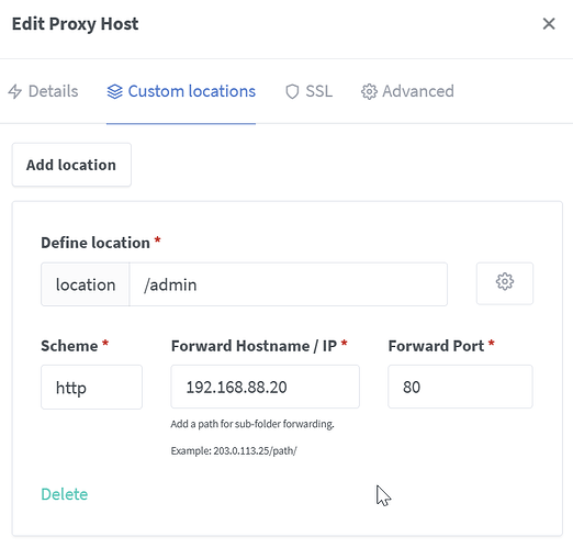

I can't connect to webgui via Nginx Proxy Manager. Error: "502 Bad Gateway --- openresty".
Tried also macvlan driver and custom location on NPM is set.
