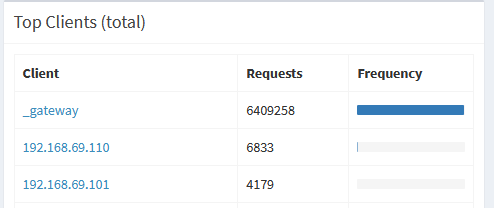

Hey there,
im sure this is just a configuration issue but is the following normal?
i am using DNSmasq to use the pihole as the dns for the router

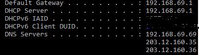

below is the output from ipconfig for one of the clients.
so dhcp is currently the router and pihole is the dns
i understood that this route "wasnt the best option" but the number being reported got _gateway seemed kind of high even from minute one of getting it going
(has been going for about a week), just wanted to confirm if this was normal or not

I would have DHCP only give the pihole for DNS. Your picture shows it giving other DNS servers as well. I also have my network handle DHCP rather than my pihole as it can't handle complex networks as easily.

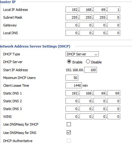

hmm, i think i understand what your saying and i thought thats what i was doing maybe not?
here im telling my router about the dns at pihole
and here im setting the upstream back to the router
as far as im aware im not setting another dns anywhere else hmm
Local DNS setting for router should be the pihole address. Upstream DNS I would set to another public DNS provider and then you can enable CF on pihole so you can get hostnames in your pihole graphs. if you dont want the hostnames I would remove the upstream DNS setting and just let the pihole do DNS.
CF requries your router IP and that your subnet is all on same configured domain.

well i tried local dns in the start it didnt seem to work... but i tried again filled in the gateway also and i think its fixed the _gateway in pihole has droped down. and my router isnt at 100% cpu anymore haha.... thankyou!!
Another question for you any idea how i delete the data stored for _gateway? casual 28,913,547 queries lol
