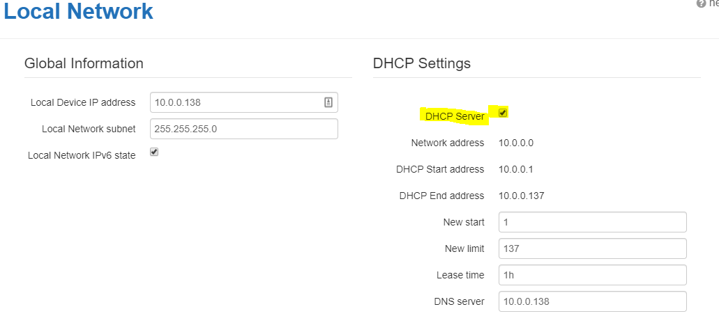

Based on what little insights your router config screenshot conveys, it seems like your router resides at 10.0.0.138 and is handing out itself as local DNS server in its DHCP Settings.
Hence, it would be sufficient to replace DNS server with your Pi-hole's IP address.
However, your Pi-hole has to be issued with an IP address on the 10.0.0.0/24 subnet, which is currently not the case :thinking:
While your windows 10 machine resides at 10.0.0.88, it seems you have completely isolated your VM's network, with it's outside IP being 192.168.137.1 while using 172.18.46.118 internally.
You have to either find a way to assign an IP address within the 10.0.0.0/24 range to your Pi-hole, or to define a respective route to the current outside address.
