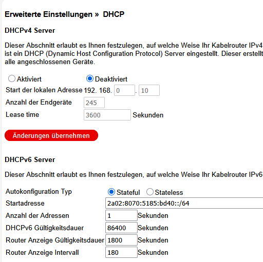

I still struggling with this situation. Perhaps you need more information. My router is a connectbox from Vodafone - a rather old one (7-8 years old) - so far working good and stable.
I know that running pi-hole with a connectbox is not that easy, but it worked in the past, only with this new setup I don't get it running.
The settings in the router are like this:

Obviously it has something to do with my Connectbox. I just got it running, blocking rate around 20%. But after 1,5h the internetconnection was down. Didn't change anything on the setting of the router or pi-hole.
Does anyone have experience with the Connectbox + pi-hole?
