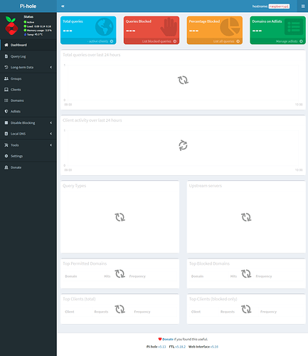

I am running a Raspberry PI 4 8G board.
I had been running Raspberry OS 32-bit for months and had been running a number of services on the device including pi-hole and everything worked great.
I just did a fresh install of Raspberry OS 64-bit OS on a new SD card (release date 9/22/2022).
I have loaded nothing other than turning on VNC in raspi-config.
I then loaded the pi-hole using the curl command. I am using all the standard defaults from the install script.
I would expect the admin interface to work as before.
Pi-hole is working and blocking. the admin interface does load, but the dashboard screen looks like this in Chrome. It works fine in Edge and on pi-hole remote on iOS. I have disabled all extensions in chrome even though none of them interfered with pi-hole before. I have also rebooted the RPI:
(https://tricorder.pi-hole.net/9AHtjIbu/)
any suggestions are welcome. Is this an incompatibility with the Raspberry 64-bit latest edition or just chrome? I have seen some very old issues that were unique to Chrome from years past on this site but none seem to apply to this.

No. Pi-hole is compatible with both 32 bit and 64 bit RaspberryPi OS.
If it is working using other browsers, your installation is working correctly.
The problem must be on Chrome side.
Do you see any error messages on Chrome?

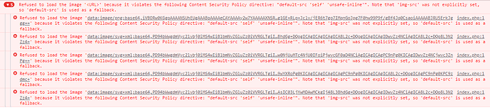

That's what I thought, too.

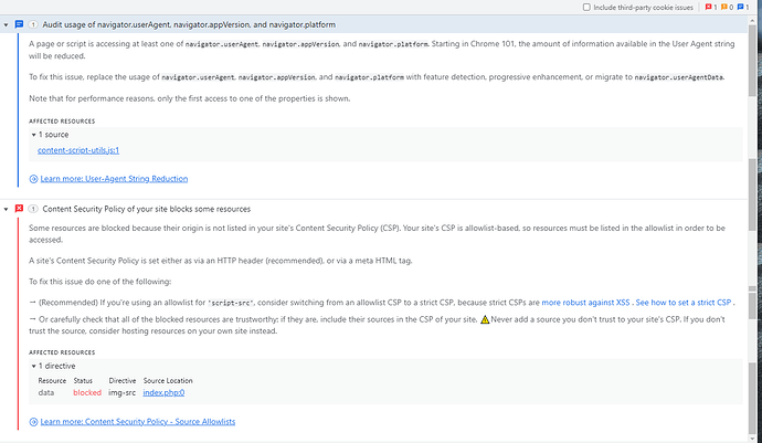

Here are the Chrome errors. I am not sure they make sense to me. Any thoughts?
LJ
On the first image, the first item (marked in blue) is just informational and it's not an issue.
The second one (in red) is telling your browser is blocking some resources, but the second image shows only images (some SVG icons) are being blocked.
This shouldn't happen, but it doesn't look like it is causing the dashboard error.
Do you have any other errors or warnings? (reload the page while Developer Tools window is open)
Did that and the errors were the same. I am not and expert and page design but my read is that something in the security profile of the page design is not palatable to Chrome. Also, what troubles me is that it worked fine before the OS change and new setup of Pi-hole. There have been no changes to Chrome. I have a hard time thinking it is a problem with chrome. The only changes were OS and new install of pi-hole. The Chrome is running on a windows 10 machine that was unaffected by the changes.
An OS update could change A LOT more things than a pi-hole update.
Pi-hole did not change Content Security Policies recently.
Also, this problem is not happening for every one using Chrome. I don't see these errors here.
From my point of view, looks like the problem is on your side, but I'm trying to understand
