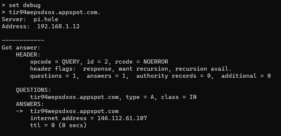

nslookup testing
I did some testing with nslookup. When I issue an nslookup for a domain without a trailing dot (noting nslookup unwanted behaviour) I can see the query for the domain with the local connection specific suffix (see ipconfig above) in my pihole logs, which returns nothing. nslookup then queries the primary domain without a suffix but I can't see that in PiHole logs. Again, it looks like another DNS server is being used for some portion of the queries, or PiHole isn't logging some queries.
(nslookup output summarized for brevity, AAAA queries removed as they're essentially a duplicate of the A query)
> nslookup
Default Server:  pi.hole
Address:  192.168.1.12
> set debug
> uy054eprsdoz.appspot.com
uy054eprsdoz.appspot.com.home.arpa, type = A, class = IN  (no answers)
uy054eprsdoz.appspot.com, type = A, class = IN
ANSWERS:
    ->  uy054eprsdoz.appspot.com
        internet address = 146.112.61.107
        ttl = 0 (0 secs)

When I issue an nslookup for another domain on my blacklist including a trailing dot it sometimes seems to work as expected.
> nslookup
> set debug
> armantark.com
Sep 15 08:14:08 dnsmasq[316]: query[A] armantark.com from 192.168.1.38
Sep 15 08:14:08 dnsmasq[316]: gravity blocked armantark.com is 0.0.0.0
Sep 15 08:14:09 dnsmasq[316]: query[AAAA] armantark.com from 192.168.1.38
Sep 15 08:14:09 dnsmasq[316]: gravity blocked armantark.com is ::
> tir94wepsdxox.appspot.com
    QUESTIONS:
        tir94wepsdxox.appspot.com, type = A, class = IN
    ANSWERS:
    ->  tir94wepsdxox.appspot.com
tir94wepsdxox doesn't show in the PiHole logs at all.

First query at 09:10:35 (logs shown below) from work laptop
>> nslookup flurry.com
Server:  pi.hole
Non-authoritative answer:

Second query at 09:10:46 (logs shown below) from work laptop
>>  nslookup flurry.com 192.168.1.12
Server:  pi.hole
Addresses:  13.251.69.97

With a trailing dot after flurry.com at 09:12:00. No logs appeared. From work laptop.
>> nslookup flurry.com. 192.168.1.12
Server:  pi.hole
Addresses:  18.136.37.69

I then did another query for another spam domain from the work laptop, to make sure DNS caching isn't a factor.
>>nslookup uy054eprsdoz.appspot.com 192.168.1.12
Server:  pi.hole
Addresses:  ::ffff:146.112.61.107
          146.112.61.107
Logs appeared, with the suffix
pihole.log:Sep 27 09:19:49 dnsmasq[314]: config uy054eprsdoz.appspot.com.home.arpa is NXDOMAIN
pihole.log:Sep 27 09:19:49 dnsmasq[314]: query[AAAA] uy054eprsdoz.appspot.com.home.arpa from 192.168.1.38

Not quite - that laptop is sending them for sure, or else you would not see an IP address as answer.
As the corresponding requests do not show up in Pi-hole's Query Log, that confirms that another DNS resolver is answering them.
It would be normal for nslookup to construct and issue additional DNS requests by appending the local search suffix to the requested domain. It would not do so if you were requesting a fully qualified DNS resolution, as you did by appending the trailing dot.
Furthermore, I'd expect those search domain requests to be replied with NXDOMAIN (unless you'd had configured DNS local DNS records).
Your nslookup results from above as well as the log output are consistent with that:
This would strongly suggest a component that intercepts DNS for your work laptop and forwards requests for public domains to an unknown upstream, while leaving local domains as identified by the search domain suffix to the local resolvers.
The most likely candidate would a piece of software interfering with DNS on the offending laptop itself, like an aforementioned antivirus package or some kind of DNS proxy (perhaps set up by the company issuing that work laptop?).
Thanks Bucking Horn. I agree, there must be something intercepting DNS requests. I'll consider this solved, but I'll update if I work out what's doing the interception in future.
The laptop doesn't use the antivirus system mentioned earlier, but there's a few bits of corporate software on the laptop that could be doing this. I might be able to work out what it is, but that's not really necessary, and would probably take a lot of effort.
