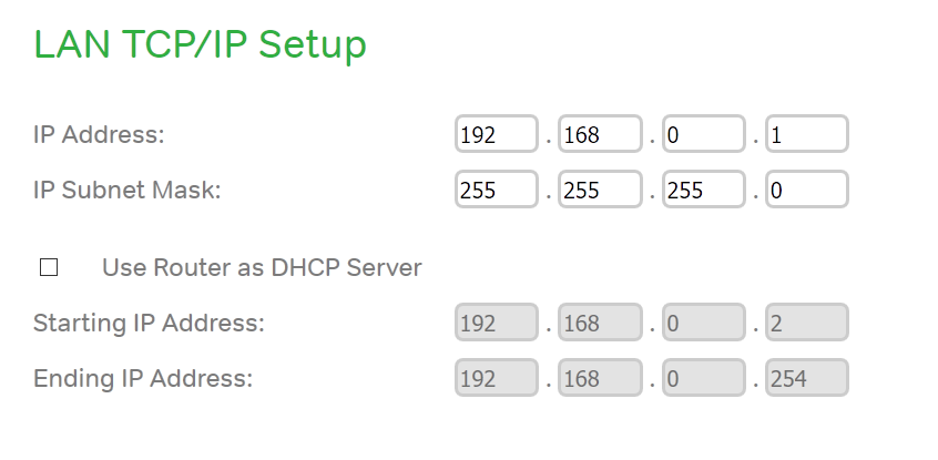

Router settings :-

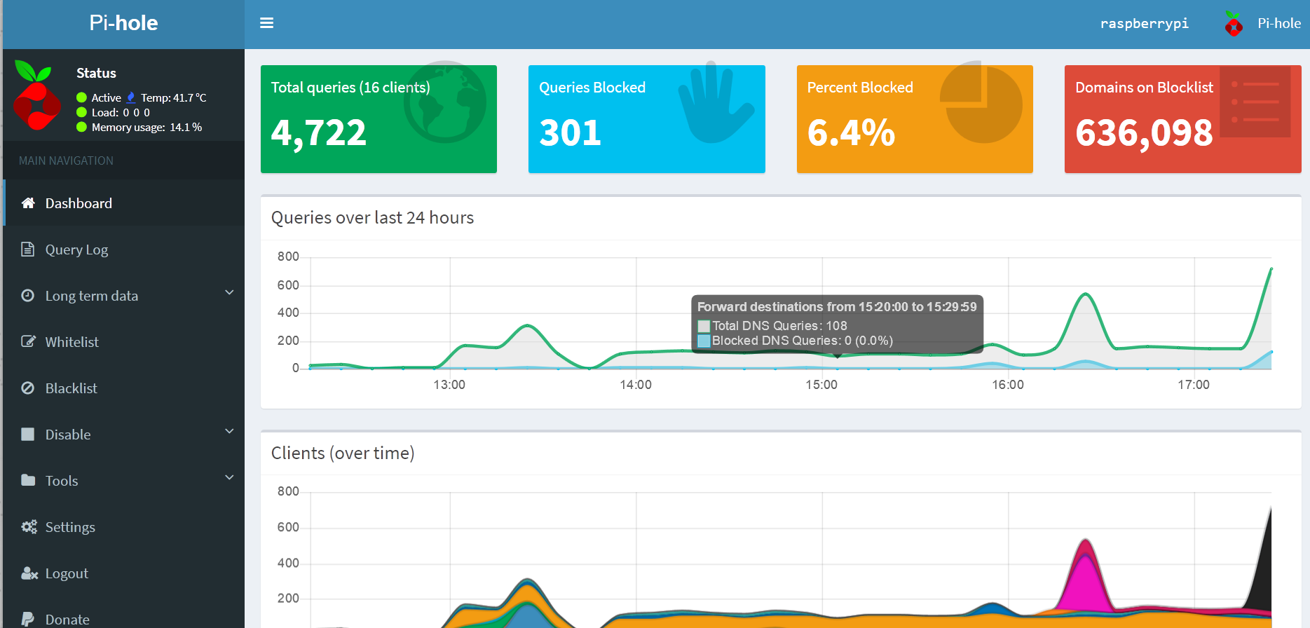

PiHole admin :-

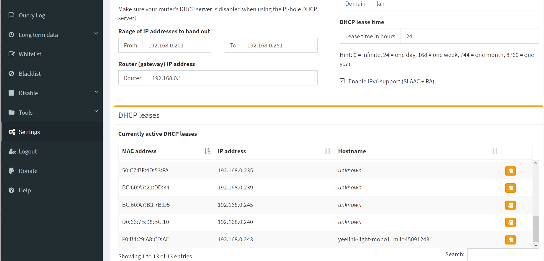

PiHole DHCP :-

Based on your screen shots, Pi-Hole is blocking domains. That's an indicator that PiHole is working properly. You have active clients, queries are being received and processed (301 queries blocked).

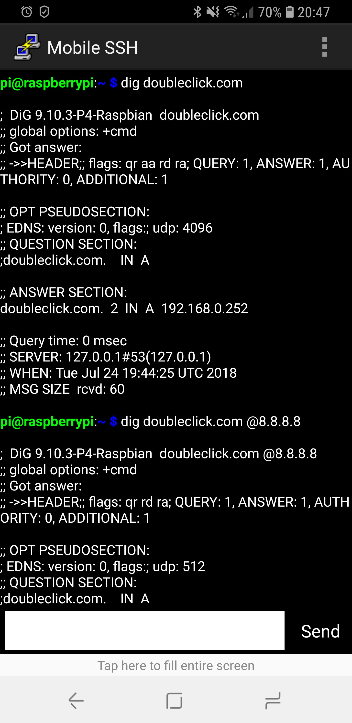

You can determine if Pi-Hole is working properly - from the terminal on your Pi run these two commands and see if the known ad-serving domain is blocked on the first command, and not blocked on the second command:
dig doubleclick.com - this will route to your default DNS server, which for the Pi should be PiHole. Your returned IP address should be the IP of your PiHole. You should also see this domain as Pi-Holed in your query log.
dig doubleclick.com @8.8.8.8 - this will bypass PiHole and route the request directly to the Google DNS and the DNS address for this domain should return. You should not see this request in your query log because the request will not be presented to PiHole.

1st query

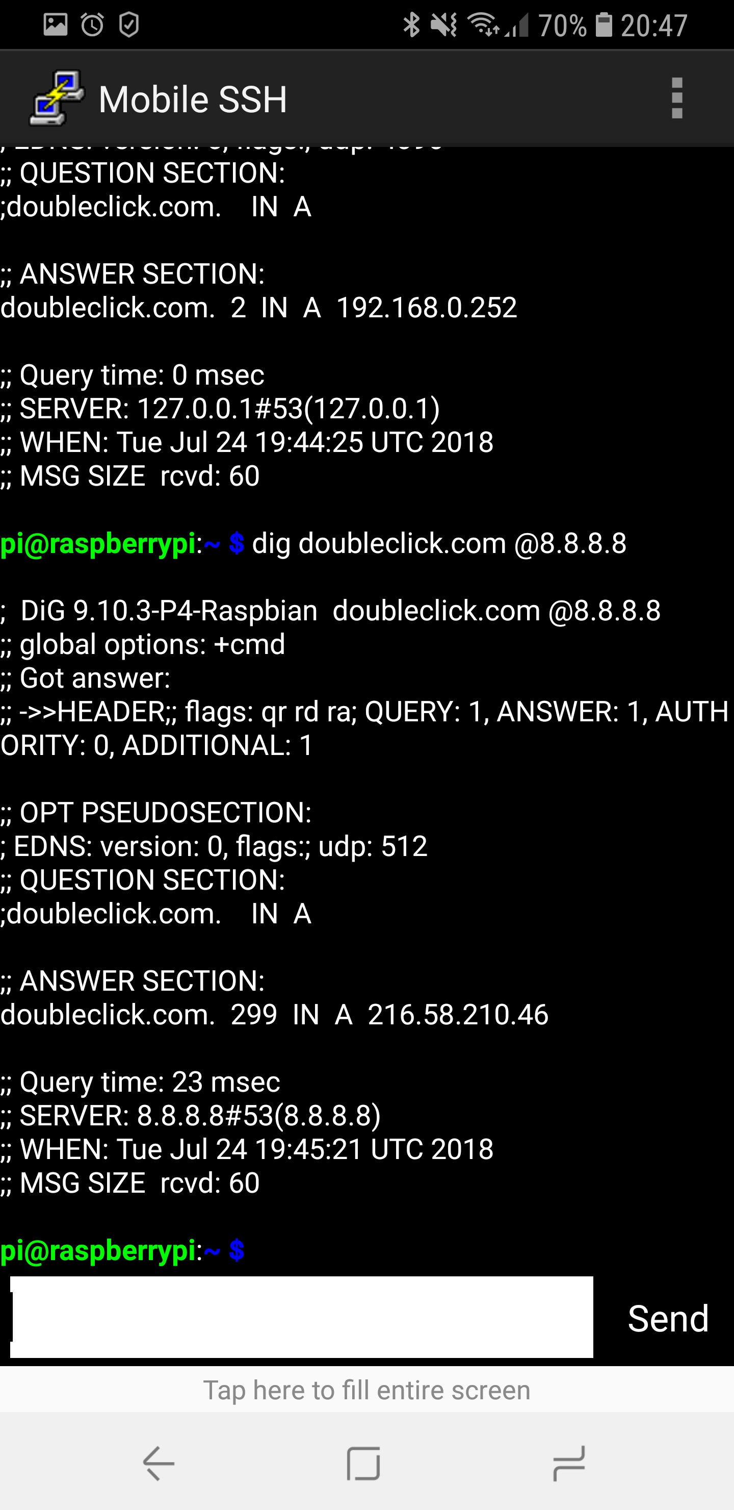

2nd query

That's a step in the right direction. Your Pi-Hole IP address is 192.168.0.252, it appears. The first screen shows that Pi-Hole blocked this address and returned it's own IP. The second screen shows the correct IP for doubleclick.com since it came from Google, not Pi-Hole.
From your laptop, run either dig or nslookup with the same arguments. From the laptop, the router is in the equation. The previous test from the Pi used the Pi-Hole specified DNS service and had no interaction with your router for DNS.
The reason your other software works to block ads is that the software is local to that machine and blocks ads at the client. What we need to do is get your devices to go through Pi-Hole only. As is, they have a sneak DNS path around Pi-Hole, so we'll figure out if it's in the client or in the router.

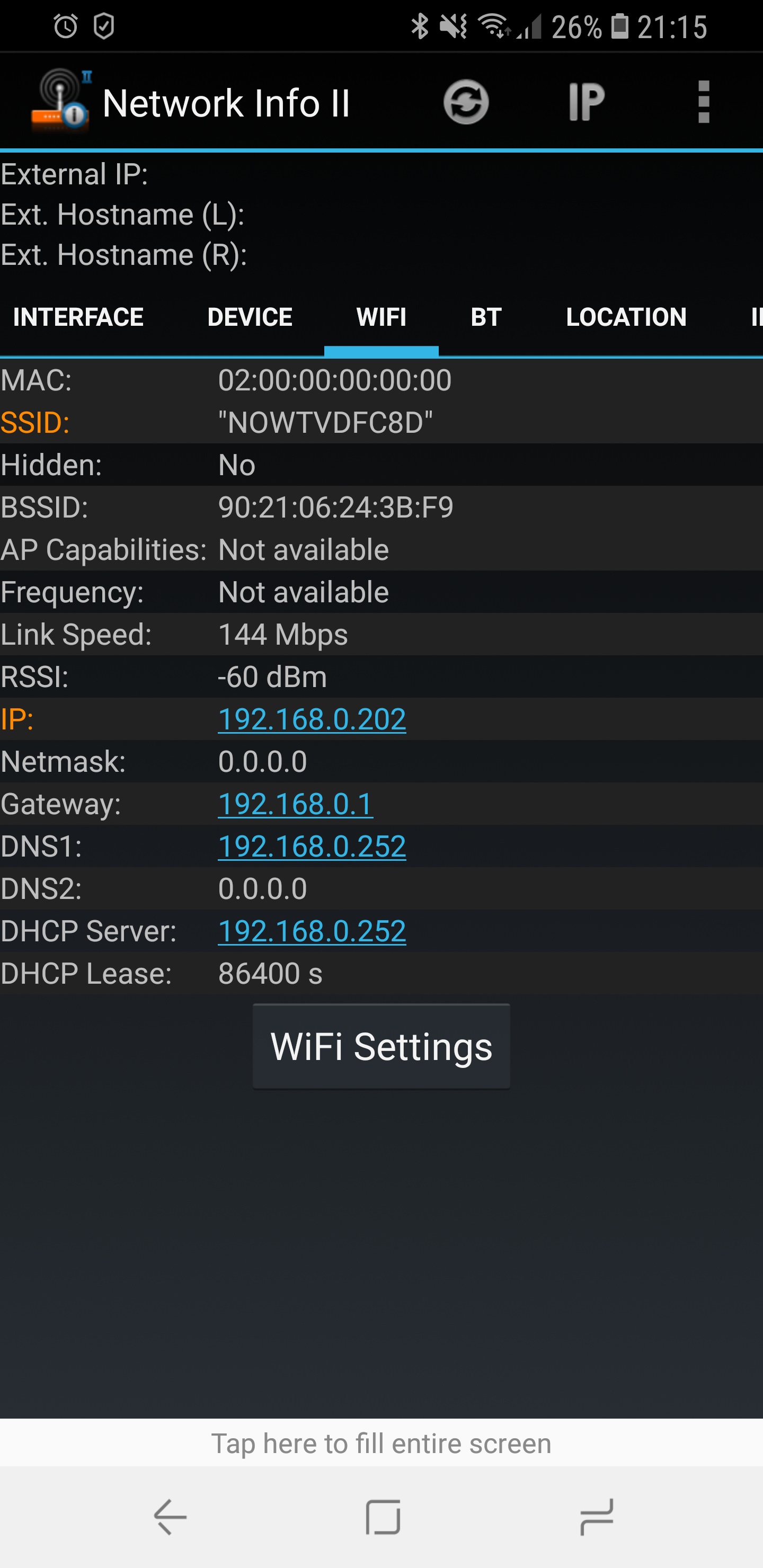

Trying to set my mobile up now, given it a static IP address, but it doesn't seem right yet.
Screenshot from Network Info II :-
P.S., any modem / router that you'd recommend? I'm happy to use the Ubiquiti for wireless.
I wouldn't think your mobile would need a static IP - the DNS server (in your case Pi-Hole) should dole them out. Sometimes you need to flush the caches on a mobile device and renew the lease to clear out the old DNS info.
